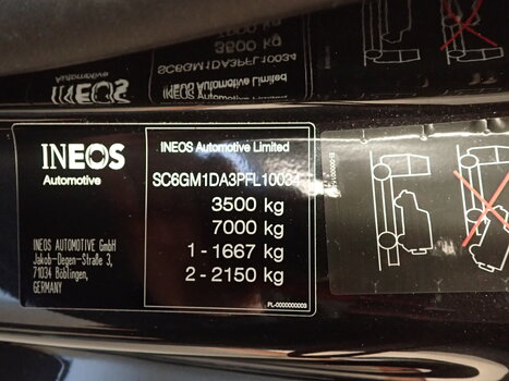

Does anybody know the max axel loads for the Grenadier?
Good question, after a brief look through existing literature, I can't seem to find them.
Edit: but it was in the photos...
That's 3817kg, so a 317kg GVM upgrade, or in Australia where the GVM is 3550kg a 267kg GVM upgrade.
So in Australia at least it should be simple, and relatively cheap to get a 267kg GVM upgrade with a minor engineers report, but if you go over 267kg you will need an extensive engineers report with multiple high speed fully laden emergency stops and swerve tests, the hiring of a test facility, suspension upgrades, and suitably rated tyres and rims.
When I did the combined axel GVM upgrade on my Amarok in 2021 the cost all up including the engineers report and the government inspection at regency park South Australia was approximately $1400.00, if I had gone above the max axle rates for the GVM the engineer said it would be an extra $8000.00 plus suspension modifications.
The engineer also told me that if you did identical upgrades on multiple vehicles you would only have to pay for one extensive engineers report.
