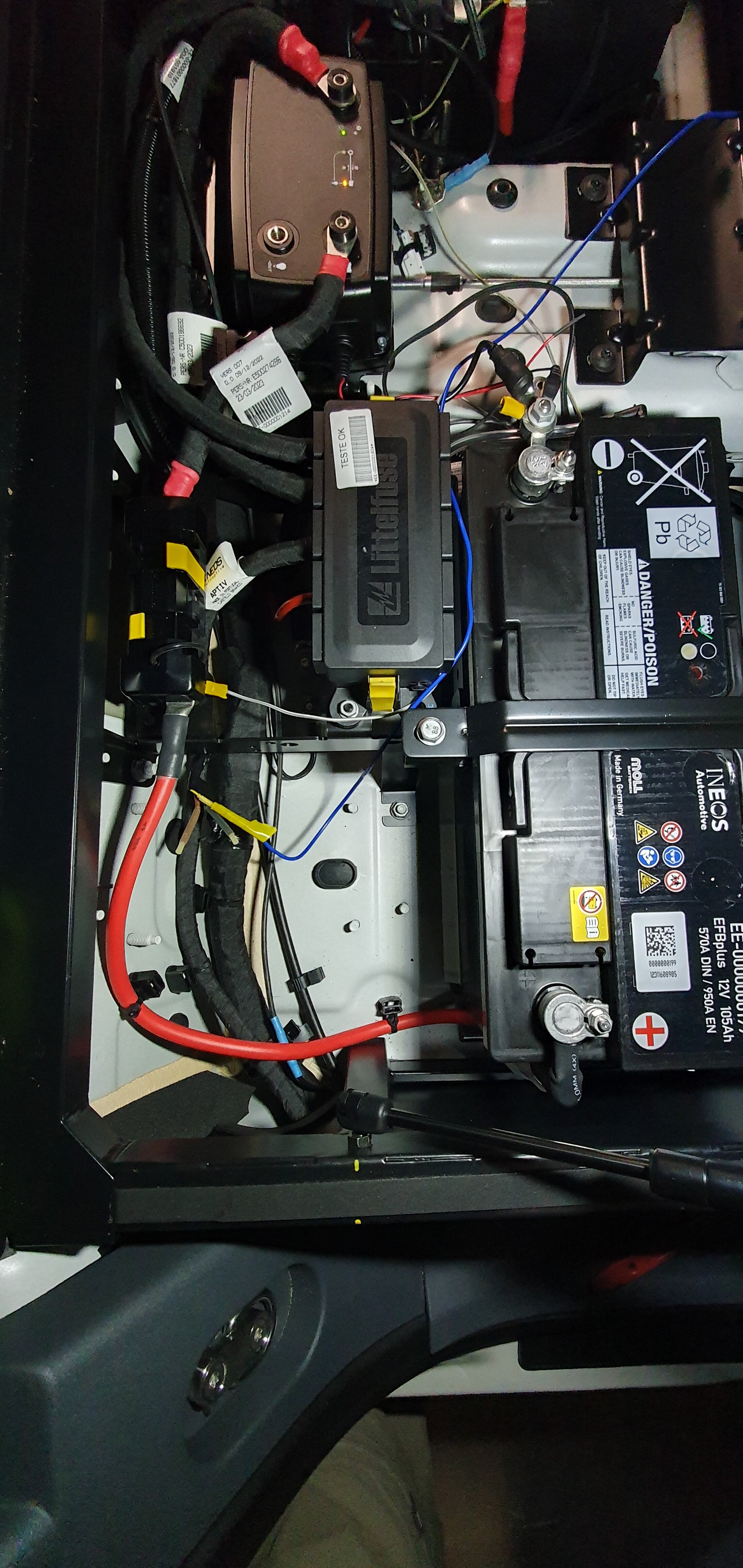

Is that another power take off wire taped to the loom - looks like it - look at upper left corner of photo where extra black glossy tape appears to be holding one or two extra wires. Please check if you can and let us know. If it is another power take off wire, please provide both close up photo of extra wiring and a farther away photo so we can see where all this is. Also if you know what switches may power it and any more info. Perhaps I am just looking too much at too many detailed photos....DaBull
That’s exact one of the questions (after searching on the forum first) to ask if anyone knew where These are connected?
I need to check with a volt meter if they are connected to one of the switches. But I only have the standaard switches, not the extra switch board. IMG_3413.jpeg
That’s exact one of the questions (after searching on the forum first) to ask if anyone knew where These are connected?View attachment 7825663
I need to check with a volt meter if they are connected to one of the switches. But I only have the standaard switches, not the extra switch board. View attachment 7825662

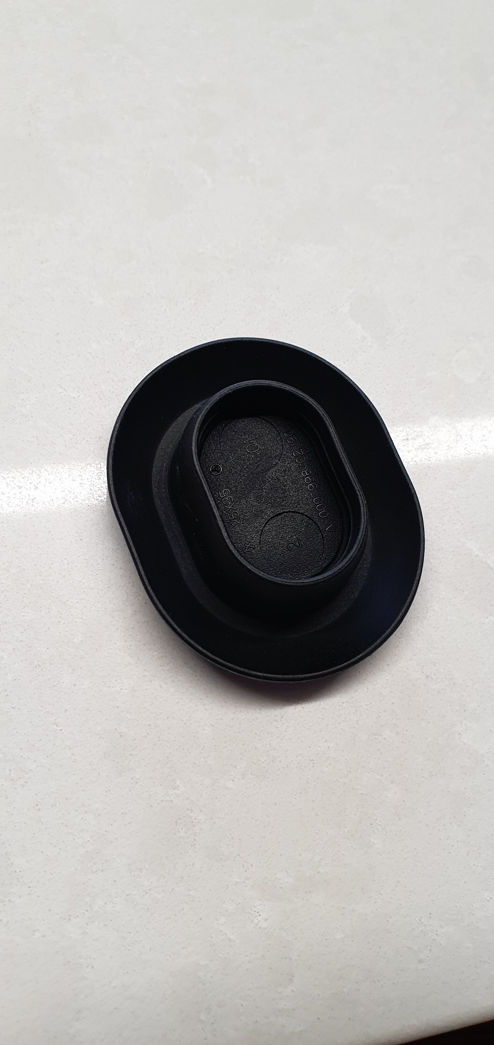

This happened to me a while back and as others have said, it takes very little pressure to pop it out (downwards). I was looking for cable exit points and thought "Ooh, this looks good, I'll give it a little prod with my finger" and it just popped out and disappeared somewhere around the chassis rail. I tried an inspection camera, to no avail - the only way to find it again was to drop the tank guard and I could not be bothered. Gaffer tape it was.
I also checked the opposite side (LHS) under the fuse box and lo and behold, that one had not even been installed! I ordered some from the friendly dealer in Ballarat and they had them in within a few days. Picked them up today and they are a right B*****rd to install - I think they are meant to be installed from below. Anyway after a bit of cursing and much fiddling I got them in and will not go anywhere near them again (even though I have two spares).
They are designed in such a way that pressure from underneath will not dislodge them but a gentle prod from above and it's good night nurse! I'm no engineer but would have thought that a groove at the base of the grommet would make it fit more securely.
