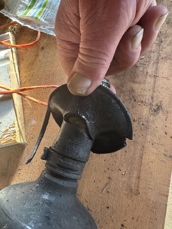

Ok So I'm replacing the CV joint on my front drive shaft. I have been carefully inspecting the boot which had only just torn and I caught it before any grease had come out. It tore radially exactly along the line of the gradient change in the thickness of the boot palpable when you insert your finger into the boot.
So please excuse me but from observation of my boot it does not look like a pinch and in fact if you take the still good axel end CV joint to its extreme range and shine a light behind you can clearly see a gap at the apex of the fold. There is no possibility of a pinch that I can see. See images. Or am I missing something. ???

The only thing that stops the joint is "pinching". Meaning the max angle you found was due to the joint hitting physical limits due to the boot and the boot flange. If you remove the boot completely you can disassemble the joint by over rotating it. The pinch happens behind where your light is coming through. Your boot failed in a very normal manner and ist how they all fail. Cut a cross section of your boot and you will likely find the thickness of the boot varies at the spot it was split. The boot however should be uniform thickness in the area it split.

So that's a Circlip failure from lots of articulation and pushing and pulling on the retaining clip. Interesting that they still happen at the Transfer box end not the axel end.
Yes there is a definite step in thickness that actually symmetrical through the whole radius of the boot - ie all the way round at that exact point where it fails. Is this how the boot was made with a step in thickness? Or is this the wear with motion? The tear is exactly along the change in thickness of the rubber.
That's the area being pinched. The boot in that area is supposed to be uniform thickness. But the pinching causes a step down then a taper back to full thickness.
Clip failure happens at the T-case because the joint is under more stress from exceeding its max operational angle. The diff side does not exceed the joints max angle.
My initial post was supposed to be a friendly heads up to the community on ONE of the ways to identify a potential driveshaft failure visually, BEFORE it happens, (as quite a few people have asked what they should be looking for) but it caused a bit of confusion as it wasn’t the commonly seen cv boot tear. I hope this clear things up a bit.
I assume sections of the inner race in between the ball bearings cavities is coming in contact with the back cover plate during over articulation causing those dents and holes? Was the retaining clip broken also and the broken bits pierced the cover plate? It’s amazing to see how hot grease can find its way between the back of the cv joint and transfer case flange then out through what I assume are weep holes in the flange.
Behind where my light shines on the curve of the flexed boot the bearing behind has effectively moved out of the way so there is plenty of space . There is no pinch that I can see. Plenty of free space at the point of the shafts maximum angle which is only restricted by the metal flange. Not the boot in any way.
I can see debris causing this and I can see rubber fatigue at the change in thickness of the boot. That's it.
Does this step down and taper happen on the replacement Jeep CV joint boots also when they fail? Or is it the shape of the new boot when it's made?
