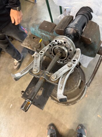

The first is doable on one's driveway, but it may turn violent when the rear joint refuses to leave.
Or the Joint will not free from the shaft splines and you don't have a puller or a vice!!!!
