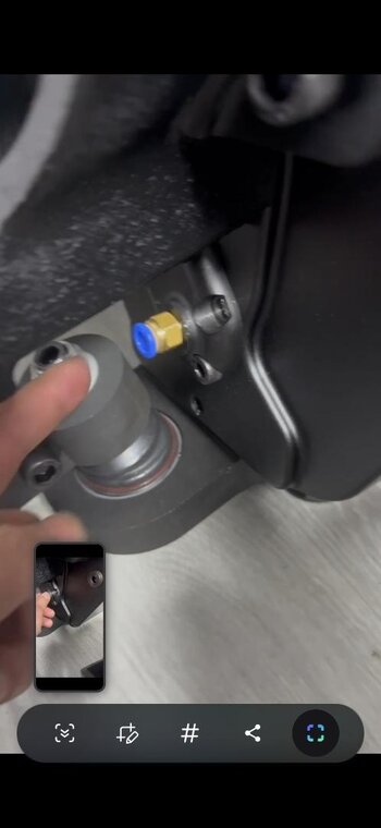

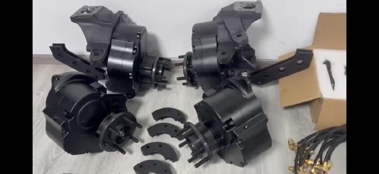

Jay Couch texted me this on Saturday. 4.7 inch portals. Said ready by Ineos Gathering. 3.7 in 3 months.
