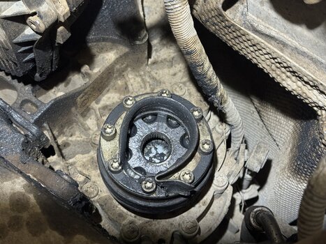

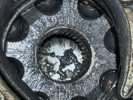

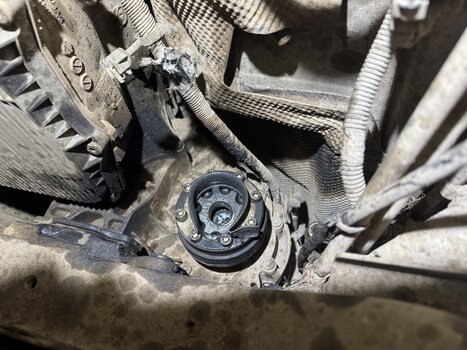

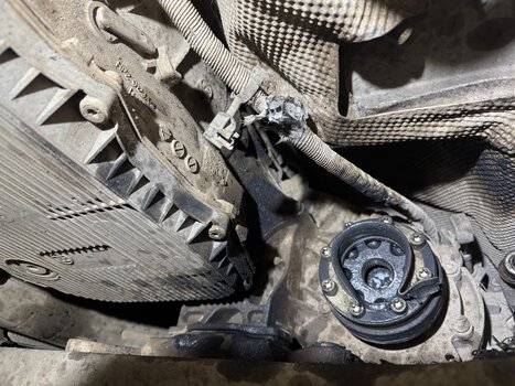

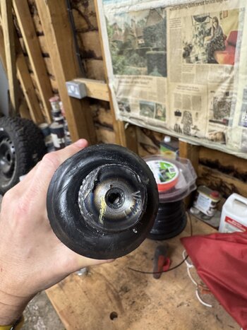

Here's the pics of the failure

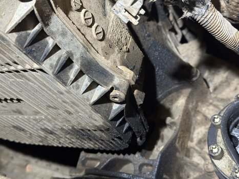

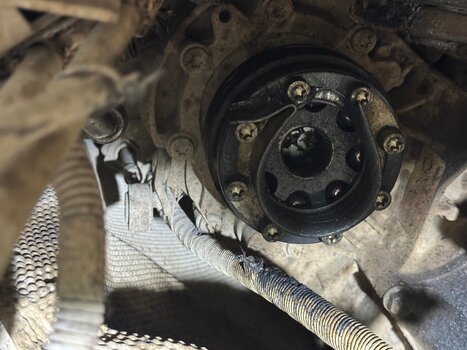

F——n hell. Check that gearbox my friend. That’s exactly where I had the small cracks , where the prop hit the gearbox at the attachment points for the plastic pan. And you were just pulling away. At 70mph on a motorway people would die !🤬🤬
Mine snapped at about 30mph and the noise was horrendous

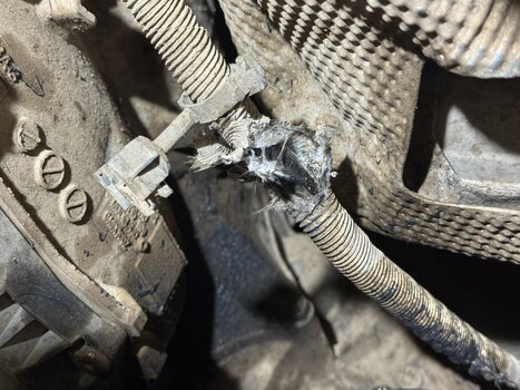

That’s virtually the same damage and break point as mine except I lost all the gearbox oil as the gearbox thermostat got damaged. New transfer box Bowden cables required to, as mine. Come on Ineos , you’re watching this . Fix it before something very serious happens.

You think the heat shielded cable in the first 3 photos is one of the bowdens?
I reckon this is going to cause someone to have a serious accident. Sure driveshafts have broken before but I think with the Grenadier it all points to a certain design flaw. Lets say I get a like for like replacement with no upgrade, can't say fills me with confidence. Maybe I'm wrong.....

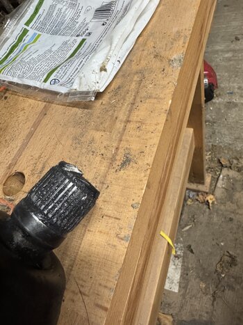

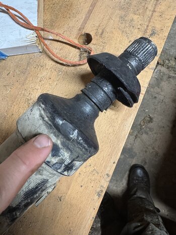

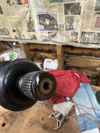

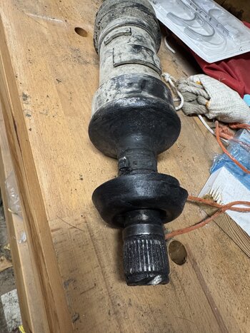

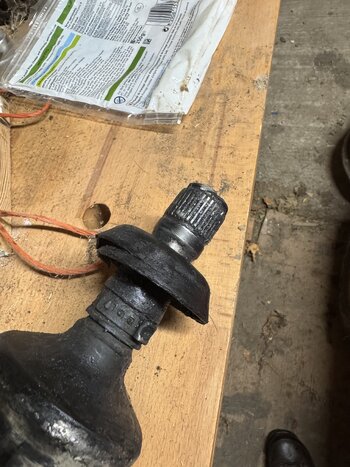

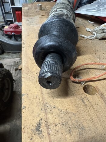

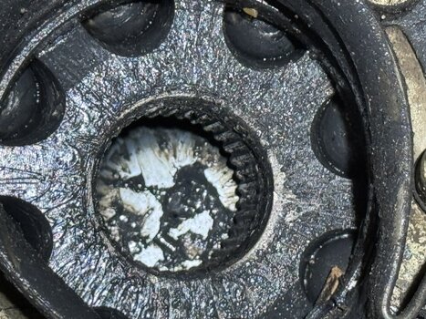

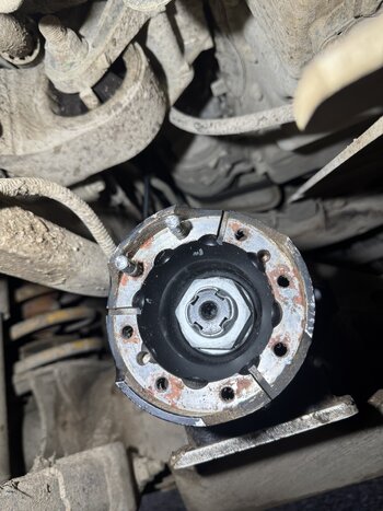

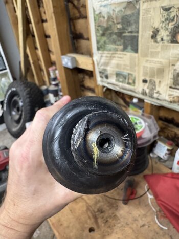

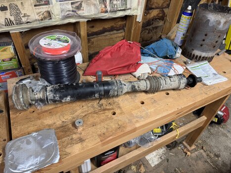

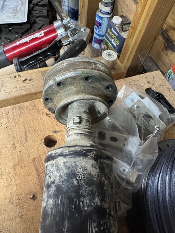

Will post a few more photos of the shaft itself.
Few more of the shaft. Not sure exactly what caused the failure.
You can see grease flung up the shaft.
Note that I had to shear two of the bolts off of the diff side as would not shift.

Its interesting to me that my drive shaft melted completely down at 70MPH but thankfully stayed in the truck, these cases where the shaft falls complete out are VERY dangerous. And I had no further damage, but a loose shaft whacking around........Crazy mine was so much worse, but stayed in. Mine might have welded itself in place.
I had transmission oil all over the road and had to phone the local council to come to site, to put absorbent granules on the oil spill, before we could leave with the recovery truck. Imagine transmission oil all over a motorway , with vehicles going 70+ mph ! Leave alone the consequences of this happening whilst in the outside lane.
Transfer box cables
