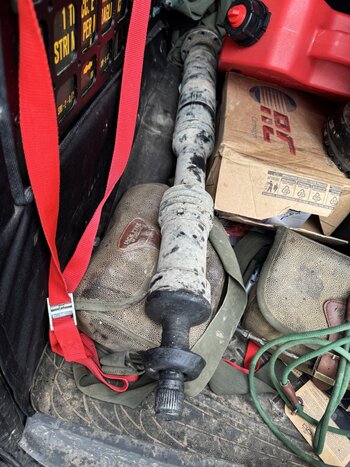

Definitely preferred it when it was attached rather than in the boot. Will pop by Chandlers in Horncastle for a chat before heading home. Will diagnose cause and report back.

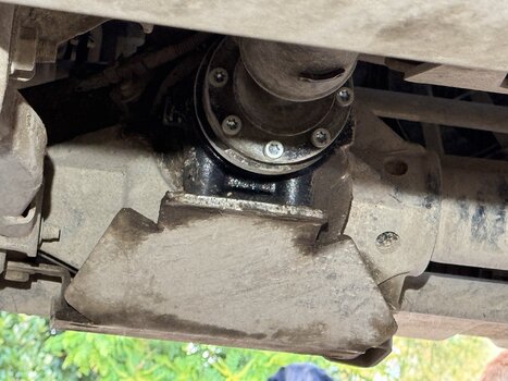

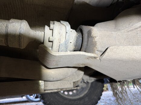

Front and rear diffs also leaking AGAIN (photo from underneath inspection day before trip)
What’s it like to drive in CDL high with the front driveshaft removed?
Sub optimal when pulling away or reversing - bit of a delay. At normal road speed I didnt notice much difference. Got a 5hr drive later so will know more then. Just want to get the dogs home in one piece.
