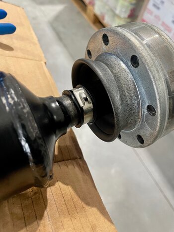

In the end, I installed a new original GRA-5D01-053980 shaft with the corresponding GRA-5D00-019750 screws.
However, I made a modification to the gearbox-side CV boot. I moved the boot closer to the joint. This is because, as you can see in the video, it reduces the strain on the rubber. closed with a Panduit inox trap.
I've also attached a video with the Teraflex boot mounted on the original CV joint, and as you can see, the rubber is under much less stress.
As for the torque at 25 Nm + 40°, it brings the torque to exactly 42.5 Nm.

modified original joint:

A simple change that I had never considered but the obvious reduction in boot flex could make a meaningful difference. Bravo.
Are the boots clamped at exactly the same place at the factory? You'd presume they are, but to assume anything just makes an ass out of u and me.
Yes the old driveshaft and the new one have the boots at the same position.
In my experience yes. There is a ridge on the shaft that the boot is designed to lock onto.
I have yet to see any difference in life expectancy based on boot placement. If you set the boot too deep the boot starts to hit the star and cage. If it's out too much you end up with the natural fold of the boot at the pinch point. Anything between that including stock is not going to buy you any more time as the boot still gets pinched regardless.
Is the boot actually getting pinched or is it wearing out because of a high degree of flex during each rotation of the drive shaft? Changing the boot placement will not help with pinching but it can reduce the amount of flex as demonstrated by ORSO.
100% gets pinched. The rubber gets extruded by the pressure and thins out. Eventually it develops a tear which centrifugal force takes advantage of and finishes the boot off.
This happens on stock or lifted trucks. Just happens faster on lifted because you live closer to the extrusion point so daily driving causes pinch. Stock vehicles only pinch when off-road of driving a bit more aggressively on road.
