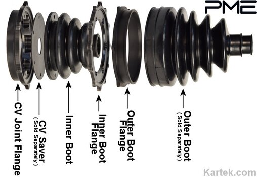

Take a look at this. First off notice how much larger this CV is and that it can operate at much higher angles. Second, take a look at the double boot CV saver. We need a larger CV and a special boot setup. Likely something like a CV saver and a small accordion style outer boot. This might be an item that needs to be serviced (repacked with grease) every 25,000 miles but really that wouldn’t be a big issue.
Before you tell me that accordion style boots aren’t used on high speed driveshaft, go look a the boots on plunge style CV’s on driveshafts. We won’t be able to use some huge floppy one but we can get something smaller that will work.

That's for axle shafts not Drive shafts. Axle shafts rotate at far fewer rpm's than a drive shaft depending on gear ratio in the diff. In the Grenadier the driveshaft spins 4x as fast as the axle shafts. Those are also being used for racing applications that get rebuilt for each race.
An accordion style would have to be more like hard plastic such as the one on the Grenadier for the slip joint. But these won't work at angle, the plastic will fail quickly.

Just trying to read the tea leaves here so a CV for a Porsche 93(x) with a CV-Saver or Double (inner/outer) accordion boot arrangement with a adapter plate to go from 6 bolt CV to 8 bolt flange on the Grenadier?
