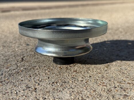

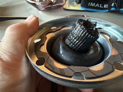

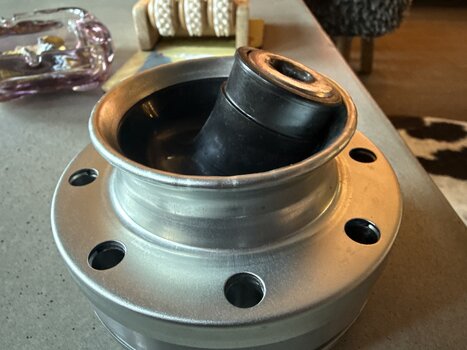

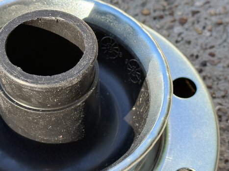

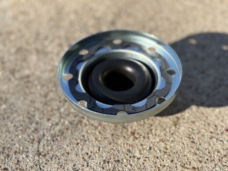

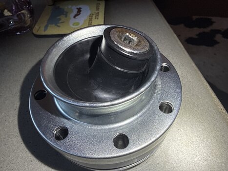

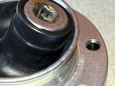

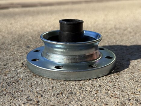

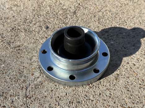

Well, I come with some new findings. Please understand this is just a quick observation so things could change. But..... after manipulating my new joint on the bench I believe I have sourced one issue. With the joint at max angle assuming the boot is on the cage and inner ball race comes in contact with the boot. It's not possible to show pics at the moment, but I will see if I can create a rig that shows the evidence in some way. In the meantime time here are some pics of the boot for everyone's reference.
Edit, the boot comes super close depending on installation. If the boot is pushed in slightly it will hit. But if it's mostly relaxed upon install with no angle on the joint then it's just super close but won't touch. As well, if installed at relaxed length the boot really doesn't get pinched at the typical point of failure. It will get pinched of course, but that's up on the shaft of the boot.
