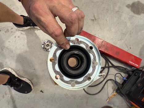

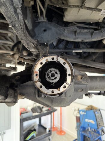

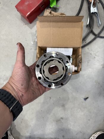

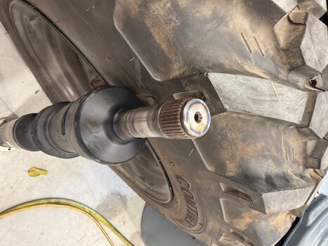

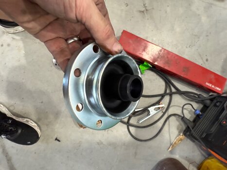

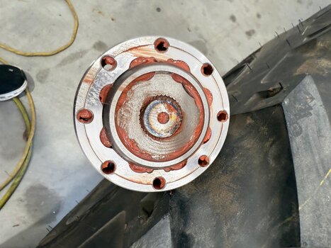

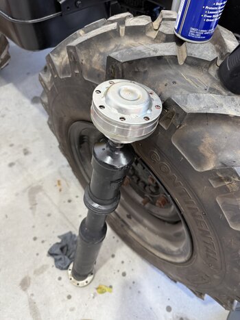

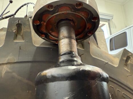

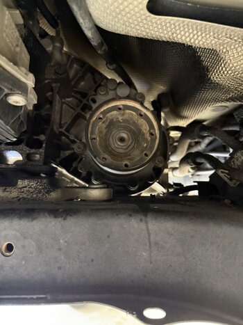

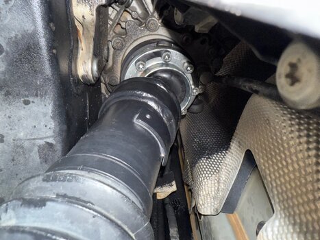

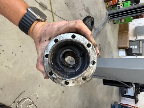

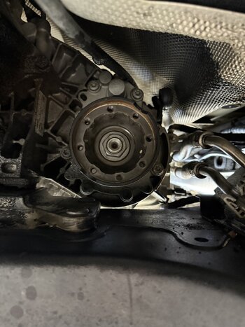

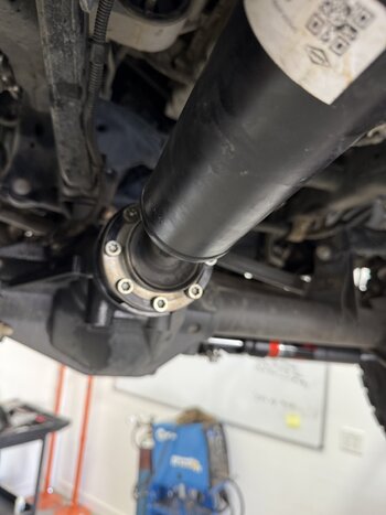

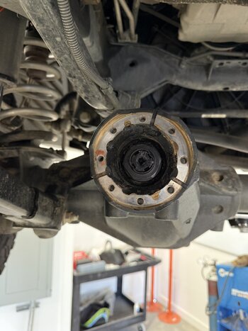

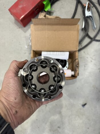

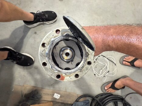

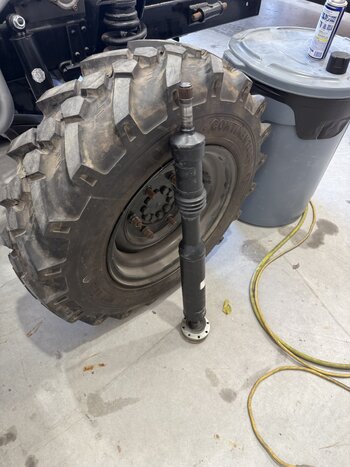

Today was “fix the driveshaft’s CV joint day” I have the 2.5” Eibach lift with Toyo open country RT Trail 35’s. I got about 5,000 miles after the lift on the OEM CV joint. Replaced with the direct factory replacement CV joint kit TeraFlex Rzeppa. I attribute the final straw for the boot to tear on my to trip to Austin dropping our boy off at college and back in 24hrs. 85 mph and 99 degrees. Just under 400 miles round trip. I have 23k miles on the odometer. Lots of off roading and highway driving!! Total job took about an 1 1/2 hours - total time 2 hrs because we we bull sh@tting!!!! Special thanks to @Dokatd for the help and use of shop, lift and tools and all the guidance!!! 🤘🏼 Hook Em’!!

Nicely done! Curious, how well do the splines engage on the new TeraFlex joint to the shaft? Is it as tight as the OEM joint or is there any play which could create a knock or clunk over time?
Also, is the OEM and TeraFlex joints external dimensions the same such that you could use the TeraFlex rubber boot shroud and back cover plate (once you cut it off) to replace the OEM ones preemptively as a sort of upgrade before it splits open and contaminates the joint or are they different enough that’s not possible? It would be nice if it were possible to keep the OEM joint and just replace the boot and dust shield before it starts causing trouble.

Nicely done! Curious, how well do the splines engage on the new TeraFlex joint to the shaft? Is it as tight as the OEM joint or is there any play? Also, is the OEM and TeraFlex joints external dimensions the same such that you could use the TeraFlex rubber boot shroud and back cover plate to replace the OEM ones preemptively as a sort of upgrade before it splits open and contaminates the joint? Or are they different enough that’s not possible?
I was surprised that the stock joint slipped right off by hand. And the new joint fit the same. Mine had to be gently pressed off.
The joints are virtually identical but clearly made by different factories. The stock boot is crimped onto the base. You would have to go to work on the old boot flange to get it off. The Terra part may interchange, but I don't see the point in that really.
