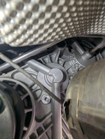

The transfer case is less straightforward because of the remote oil cooler. I opened a case with IA customer service on Sunday to supply a copy of the drain and fill procedure. Standing by...

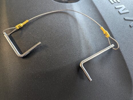

I don't think the dimension is the key criteria. Put 2.1 litres in. If you cannot accurately dispense 2.1 litres then measure the height to the surface of the oil and adjust until it's correct. Like an old school engine dipstick.
I did my diffs on Monday. I drained them and got near enough to 2.1 litres out. I put 2.1 litres into a pump pack plus another 200ml for the trapped oil in the pump and hose. I pumped it all in then measured. Close enough to 32 and 22mm. I topped up maybe another 30ml each to hit the line on my redneck dipsticks.
A big oil transfer syringe would be the go. Prime the syringe and hose with oil. Bottom the plunger. Draw up 2.1 litres. Squirt it in. Close up. Sleep at night.

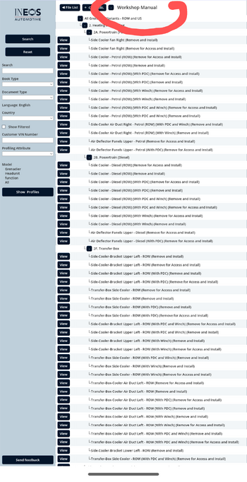

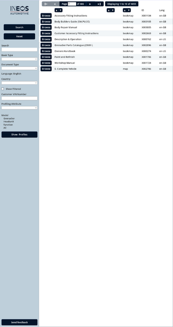

What do you mean "There are no servicing procedures in our view..."?
Our 'view' is what we can see in the portal.
The access permissions that IA have granted excludes any servicing procedures. We get some general docs, the parts catalogue, the body repair manual, and a workshop manual. That's all remove and install docs. Nothing on inspections, adjustments, damage limits, etc. The workshop manual does include installation torques.
Edit: There is some component oil drain and fill information.

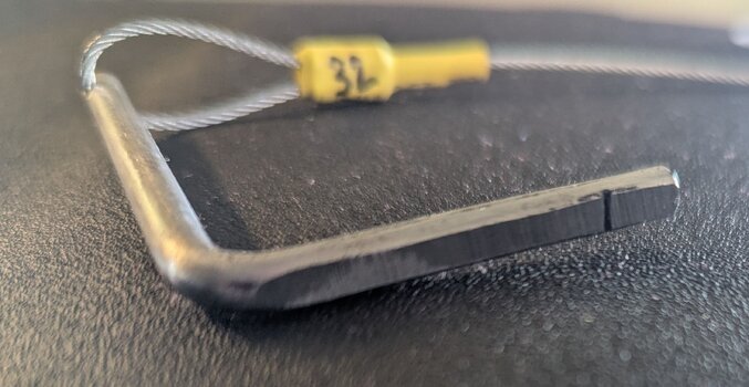

Hmmm, slightly different numbers. I wonder where 22mm and 32mm came from? I didn't make them up. I'm still of the opinion that it's the 2.1 litres that matters.
Found them. I was quoting the numbers from here not the doc you posted @Logsplitter.

As an aside I've always been uncomfortable with the precision of the front diff level (27.3mm) in the document @Logsplitter posted. I doubt anyone could measure reliably to <1mm.

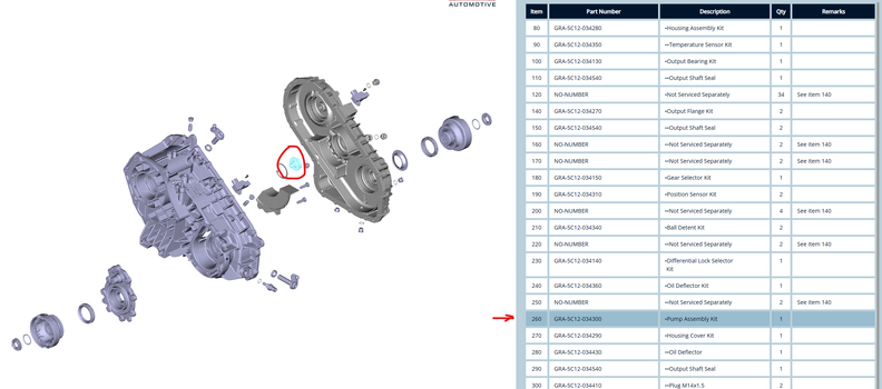

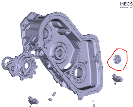

Transfer Case Oil Pump
There is a gerotor style mechanical oil pump inside the transfer case. This pump is mounted in the rear cover of the transfer case and driven by the intermediate shaft. It circulates oil to and from the cooler whenever the vehicle is moving (the intermediate shaft must be turning). A Gerotor is a positive displacement pump so oil should not drain through it when it is not operating.
Thank you for documenting the process in such great detail. There were suggestions that there was a pump that could be activated electronically to push fluid out of the cooling circuit but you're clearly showing it's mechanical -- putting the ZF into forced-neutral, lifting the Grenadier and manually turning the wheels to operate that pump, probably not efficient and might not even work, but would serve as excellent physical exercise :) I am still waiting for access to the online manuals -- received email to request access on 3 October and submitted my information, have not heard back yet.
It's another query off the list. I believe owners now have enough information to do all the oil changes should they want to, or need to due to dealer location.
The pump appears to be quite small which might explain why the greatest temperature rise in the transfer case appears to be during sustained high speed driving. That's my experience. The cooler is more than likely adequate to shed the heat but the pump cannot circulate the oil fast enough to keep ahead of the temperature rise.
