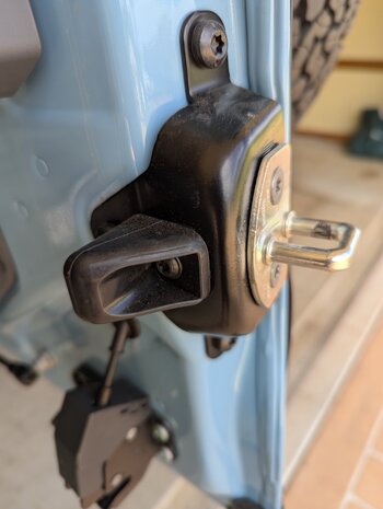

Could anybody assist with what this part is? I found it behind my car yesterday when unloading it. Stole the photo from Google but the same item and part no -
Thanks

Hey George. It's the door cushion that attaches near the latch on the big door to stop it damaging the small door if you close them in the wrong order. Held on badly by a single screw. The screw is probably still in the door. Take it out, pop a small flat washer under the head then put it back in with the cushion.

Thats great thank you very much!

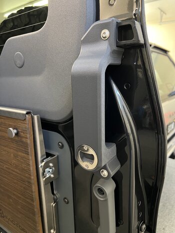

Grab ONE OF THESE and it'll never pop off again. Plus you have a nifty handle do cloer the door from the outside without dirtying your hand on the spare or dirty door.
Hey cheers, i will grab one of these!
Good call - it's a great upgrade. As are the rear license plate light shields. The reverse cam is basically useless at night without them.
As a heads up, the bottle opener on the handle is a bit interesting to use.
This is the most amazing over engineered rubber door stopper holder-on-thingy devised… its secondary function is a handle or is that the other way around? :D
Get one you won’t regret it! IA should have done something like this from the factory but hey that’s why we have sharp minded folks in the community filling the gaps.

Can you advise anywhere else to buy these ? Shipping is expensive to the uk!
The rear grab handle? That’s a custom part we manufacture and sell through the forum store. Maybe you could get some other UK folks to do a group buy to split the shipping. Just a thought.
