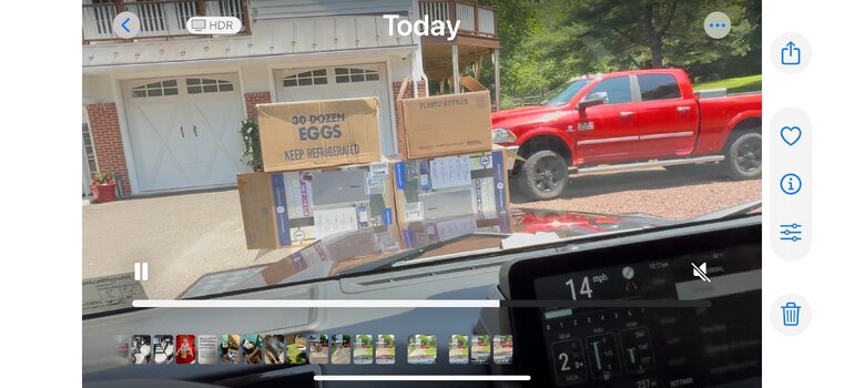

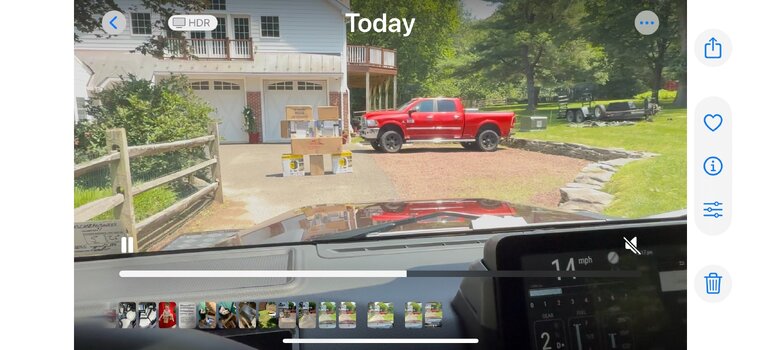

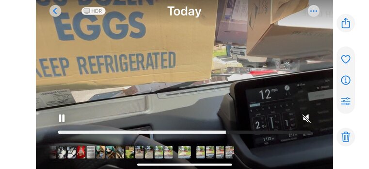

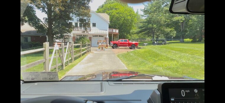

Has anyone actually had the AEB kick in and prevent an accident?
I'm used to active ADAS like in my lexus RXH+ and Toyota tacoma.
I know the CAM doesn't see the road signs and is mostly wrong with the posted speed signs, lots of pics of that.
The manual says the cam will activate the AEB system 2 seconds before impact, then it says "don't test this".... so i tested it, it failed.
I made a video but it won't Upload so I took some screen shots.
So does anyone have any experience with this system actually working the way they describe?

I tried to upload the video several times... the site chokes on it even edited down to 5 seconds.
Regarding the software and the cam capabilities, I know the software and the cam is incapable of discriminating between a 25mph sign and a 55mph sign.... i've got lots of photos of this.
So i doubt the issue with the AEB was not picking out the logo of a vehicle on my solid vehicle sized cardboard wall... Its not lidar, it should have seen a solid vehicle size wall about 6' high and 7' wide and applied the brakes. Based on the proven low functionality of the software/hardware of the system i suspect it would be just as effective against boxes or a Rolls Royce Wraith.

I hit the boxes at about 14mph per the Grens speedometer... I wanted to give myself some space between the engagement of first auto braking, then manual baraking and eventually the garage door braking with the $80K Lexus and the $100K S-500 beyond that.
