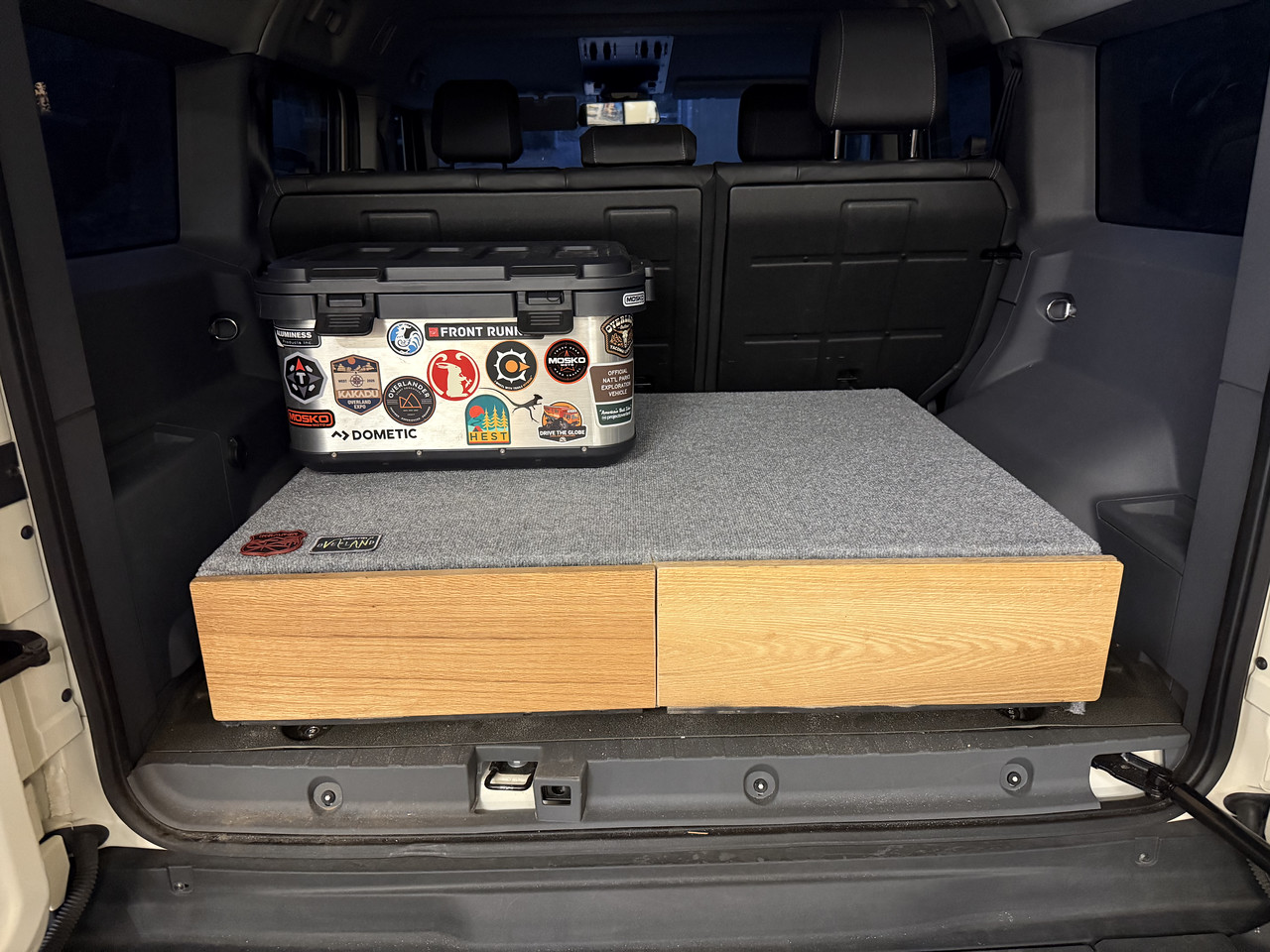

DIY - Rear Drawer system build - $150 - One sheet of plywood - 1"X8" 12 foot and 1"X6" 12 foot.
hightechcoonass
11:21 PM
May 22, 2025
54
86322
I built this today.
41" wide X 32" deep (sides and back are 1" x 8" pine boards.)
Drawers built with 1" X 6 " pine boards and plywood drop off 16" X 19" (bottom)
(Carpet was left over from my 4Runner drawer build, and oak drawer fronts we re-purposed from my 4Runner drawers )
linky to the pic
Ah!..... 4 pieces of 16" x 19" dropoff - to make the bottoms for the 2 drawers. drawers are 19" X 32" (I also covered the inside of the drawers with carpet (no rattles!)
BTW I did not use sliders... (I did the from my last 5 drawers systems ( Tundra, Tacoma, FJ, Bronco, and 4Runner). Whenever I was on an upper incline, they would always slide open and were difficult to close.
