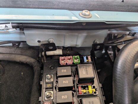

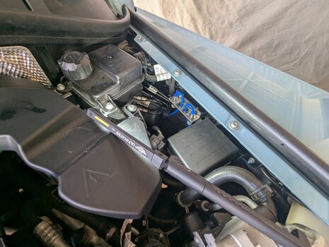

My bracket is mounted between the airbox and the fender, but @DenisM makes some good points here:
a picture worth a thousand words 😉

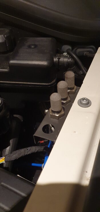

Only 2 positions have been used. The third I'd intended for either the transmission or the transfer case... at least being there I won't forget the "safe place" where other bits and pieces are sitting (somewhere🤔)

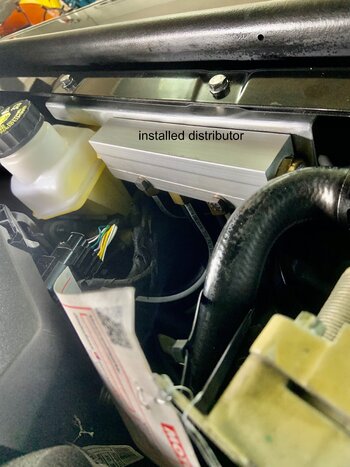

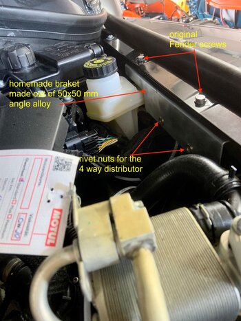

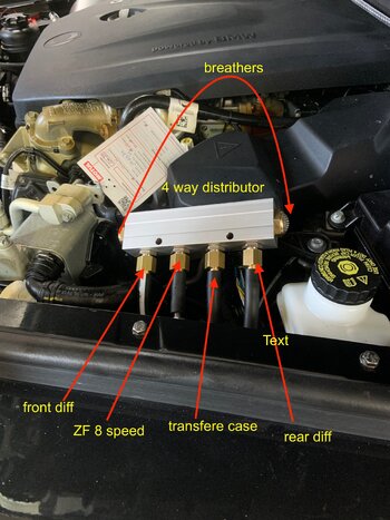

I used the same spot in the engine compartment for my breather kit. The related parts are from compressed air technology. The bracket is made of 50x50x3 mm aluminum and uses the existing fender screws. The 4-way air distributor can be easily removed, and each individual line can be blown out with compressed air.

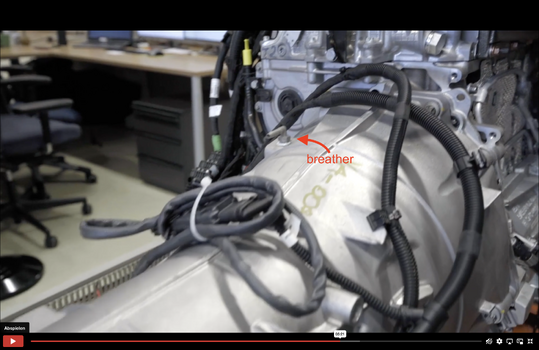

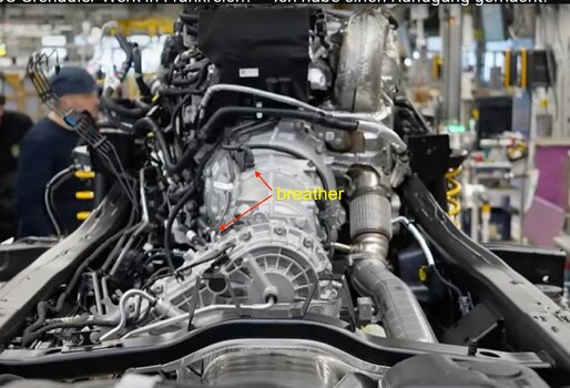

The ZF transmission is currently not connected because I cannot access the connections on the transmission. To get there, you have to remove the front driveshaft.
