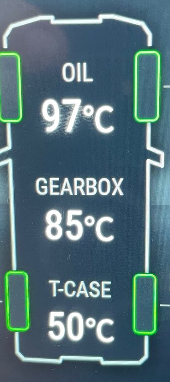

Out of interest what temps are you getting in "HI" on road? This is mine after country road driving.
Front - average 94
Rear - average 50

I get similar values as yours. Though cannot tell you what my diffs are doing unless I purchase one of those point and go thermometers

After hours and hours of cruise control set to 80mph and ambient temps around 24°C, my gearbox temp is 78°C and transfer-case temp is around 53°C... This was pretty consistent across the past 2,100 miles of driving across the country
