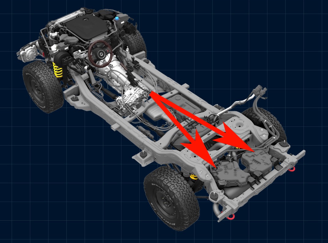

Well the B57 and B58 share the same closed deck block if its strong enough for the diesel  then its  more than strong enough for the petrol plus with the petrol you don't get the complication of Ad Blue

An interesting debate to read re the petrol v diesel, especially with the rocketing fuel prices here in the UK and the increasing penalties. Crunching the numbers, even with higher price per litre the diesel is more economical over 100 miles and I've gone for that albeit hesitantly, but mostly also for low end torque for towing. I'm assuming the BMW B57 I6 engine is Euro 6 standard compliant but haven't seen any detailed tech spec as to whether the Grenadier's engine has Ad Blu nor how many turbos are used (I believe the B57 has up to quad turbos on the BMWs)?

It has a 17 litre adblu tank and two turbos
