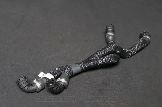

As a suggestion buy some BMW B57 B58 hoses from Ebay chop them up and see how the hoses are assembled and how the hose and fittings can be used as spares and for emergency repairs. There will the same fitting used in multiple positions so will only need a minimum number to make an emergency hose repair kit specific to the Grenadier.
Great idea 💡
