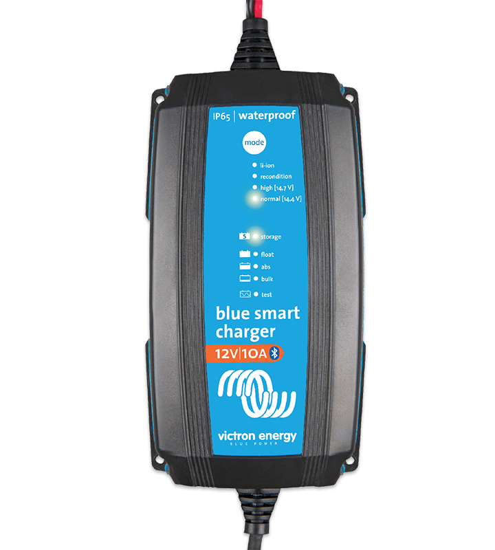

I got a Victron IP65 15 amp charger that I used to top up my battery a little after delivery. I connected it under the hood to the positive jumper terminal and it took it from 84 to 95% in no time. I do have a hardwire kit that I plan to install under the rear seat to the battery terminals once I figure out if it should go to the service or starter battery.

I use a Ctec 10amp charger (MXS10) that I attach to the charging points under the bonnet (hood). As I understand it this charges both batteries. Works well

I'm using the 25amp roof socket for solar in, rewired to a D250SE - easy enough. Probably an even easier method would be if you have a solar panel with (quality) solar controller and then plug this into the hot 12+ and neg of the 13 pin trailer plug if you have this. I've wired my ctek 10amp maintenance charger in this manner and use as required.

If your campsites have access to 220V you could use an AC charger but not hard mount it in your vehicle as this would restrict its capabilities. I would just mount an Anderson plug below the rear seat base and connect it to the positive and negative terminals of your starter battery. Then just run a power cable from the shore power and connect your AC charger. You can then charge your batteries of just use the charger as a power supply which will put out a constant 13.5V.
I would cut the clamp terminals on the charger output and replace it with an Anderson plug. I used a mini Anderson plug as my charger is only 15A and the mini Anderson is rated to 30A. The Plug above is rated to 50A.
I then used the clamps and added another mini Anderson plug so that the clamps are still useable.
