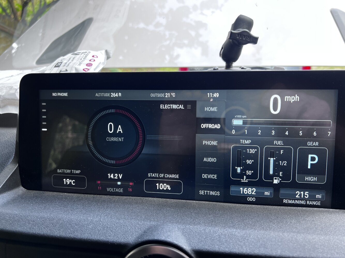

So my battery was at 94% after not using the vehicle for 5days. Was at 97% after an 86mile drive and now 100% after having the Victron smart charger connected overnight View attachment 7821684
Outside Temp 21 degrees , midday in the middle of summer.
Yesterday at midday here it was 25.9 degrees in the middle of winter.
