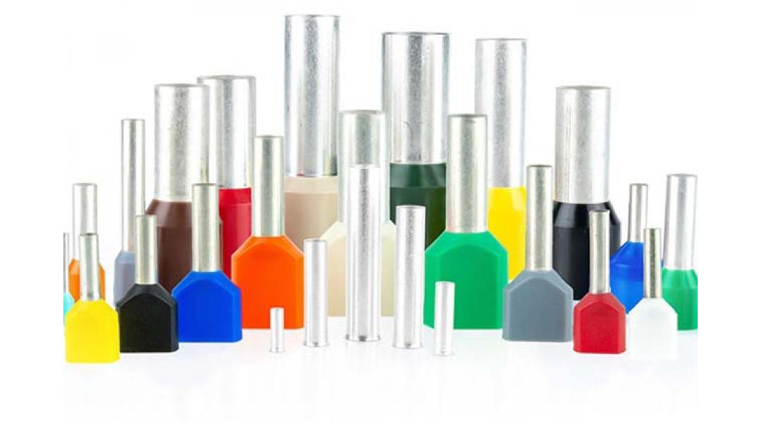

I purchased some of those a few weeks back in preparation for my solar setup. 👍🏼
I have both insulated and uninsulated bootlace ferrules. If buying uninsulated ferrules, a bell housing at one end makes life much easier.
The best bootlace ferules are copper with tin coating, not brass with tin coating. Copper is a better electrical conductor.
You also need to make sure the ferrules and the crimper dyes can handle the size of the wire you are using with the Victron. I have had to finesse this in the past. From memory 4 sided crimps fit better into the Victron, at least the one I have.
I even use the tool to make my own bootlaces! Which is why they are called bootlace ferrules. That was the original purpose.
I ended up drafting a basic guide to bootlace ferrules here (and avoid some mistakes I made along the way):
I did not use bootlace ferrules. They are one of the few shop supplies I never found after our move! I do plan to order some non-insulated ones, and I have a 4-sided crimper.
With my Victron I started without bootlace ferrules, but ended up fitting them.
