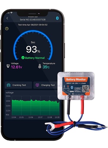

Two of these (one for each battery) or just one - depends on you..
I have one on my Hilux, they are very good (IMHO)
While I run a similar (Victron) unit on my better half's Tacoma, the fact that the app on the Streetwize unit states "SoC" really bothers me. Since all it is doing is monitoring battery voltage, it cannot accurately measure state of charge.
