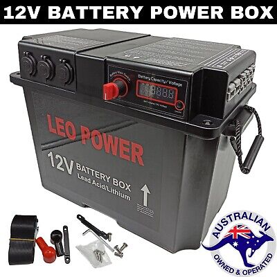

I bought one of these a while back as it was pretty much the same as the branded ones out there but, much cheaper.
I change out a couple of the sockets to better suit my needs, put in a different cut-off switch, removed the 120A Anderson and replaced it with a triple Anderson input and mounted a 40A DC-DC charger.
The wiring inside is really good and the plastic is not bad either - time will tell though.
That uses the Hardkorr box (aka they both get it from the same OEM supplier configured they way each want it). It is a solid choice. My oldest BB is a Hardkorr, still going strong after 5-6 years.
Yep, which is why I purchased it - same features but better priced. I would have gone for the Thunder box but this is only a temporary solution until my warranty expires. I also had a battery, charger and other bits so all I needed was the box.
