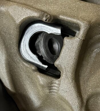

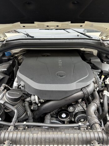

Two attachment points on the OEM B58 engine cover failed on my G. During a recent visit to the dealership, I asked whether a new engine cover would be covered under warranty. The dealership’s response was, “No, but we would be happy to order a new one for you at a cost of approximately $700.”
My answer: “No, thank you.”

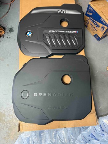

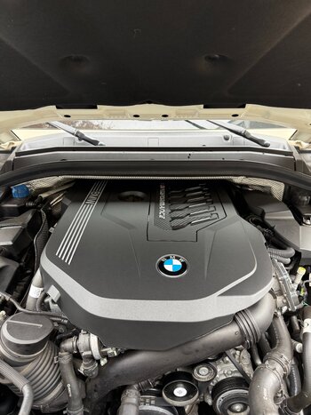

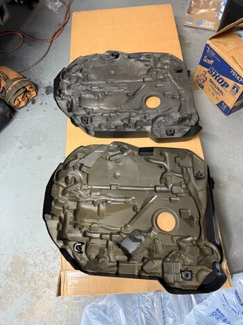

I was able to source a BMW B58 engine cover for about one-quarter of the dealership’s price. It’s not an Ineos Grenadier cover, but I actually prefer the look compared to the OEM version. It just arrived, and it’s an exact match—including the insulation—and fits like a glove.
We do have less expensive options available and in this case it has a BMW warranty. For reference:
BMW B58 Engine Cover Part Number: 11-14-8-676-205 (2020–2024 BMW models)
The dealership also offered to replace the engine cover retaining pins for $400. Again, “Thank you, but no.” The retaining pins did not need replacement. For reference, the retaining pin costs about $5.00 each.
BMW Retaining Pin Part Number:
11-12-7-643-221 (2016–2024 BMW models)

After the 1st dealer service , poking around I noticed one of the retaining pins/ grommets on mine was dislocated. The cover wasn't down properly.
I've put a dab of rubber grease on each to mitigate heavy handedness.
Looks to me when reinstalling the cover it didn’t get positioned quite right and whoever was installing it gave it a couple of quick whacks with their hand and busted the attachment socket off. When I do my oil changes I take a few extra moments to make sure the pins are lined up and gently push the cover down. If that happened at a recent service I’d for sure be bringing it up for replacement as nobody’s vehicle should be leaving a shop in worse shape than it went in.

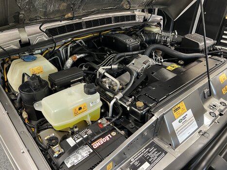

Totally agree - the under hood presentation and access of most modern vehicles leaves a lot to be desired. Even my old Rover V8 lump looks a bit more handsome than what you commonly see in vehicles today. Some manufacturers have even stopped putting in vanity covers altogether and when you lift the hood/bonnet you are staring a nothing more than a mess of wires and hoses.

I took my IG cover off after installing a tuner module and replaced it with a BMW cover off a late model B58 sedan because the IG cover with insulation wasn’t seating properly over the tuner module wiring harness.
I took the insulation off the BMW cover to eliminate any interference and not surprisingly, the engine sounds better and you can hear the turbo more. That may not be everyone’s cup of tea, but for me, it was a win-win.
