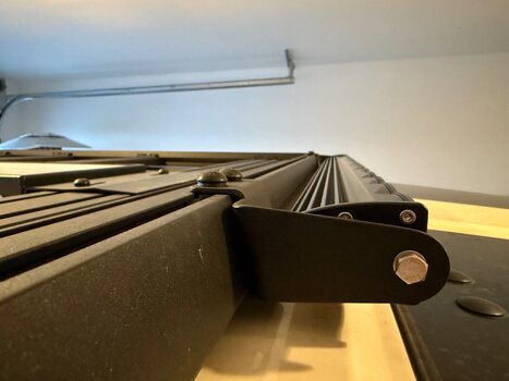

I have it on mine. It took some encouragement, but popped over the rail and bolted it in with only the top rail bolts. It’s really solid. On mine I did have to cut the bottom rail trim piece that stops the wind whistle. After installing it, I was thinking I might have been able to pop it on without removing the trim. I was a bit lazy and didn’t want to remove the rack to install, but this worked for me.
Thank you @JKAlpine ... was definitely looking for someone who has installed so this is very helpful. Good to know it took some "encouragement". I don't want have to remove the rack, that bottom windguard is a pain to snap in with the rack in place on the roof!
I just measured the two light mounts Agile provides and they differ from each other by about 2mm and the narrower of the two is about 4mm narrower than the front crossbar on the rack. I'm not sure I can give it enough encouragement and would really suck to scrap the powder coat off the Leitner rack trying!

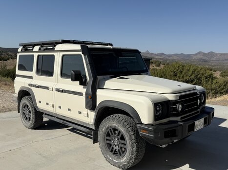

I was hoping to install the rack even with the rear of the vehicle, but in order to be able to open the windows you’ll need a slight overhang. But doesn’t look bad. (Sorry I don’t have a better shot handy, I can take a picture of the rear tomorrow).
