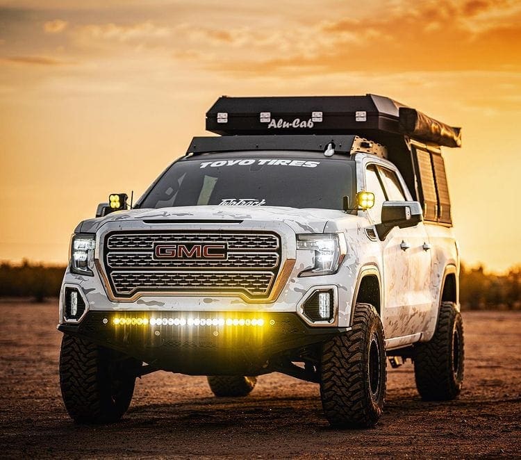

My second choice would be to wait for the Quartermaster - if you prefer the wedge camper to pulling a trailer.
You will not have to cut anything - just install an Alu-Cab in the bed, and you still get all the benefits of a canopy camper (or "wedge camper" as we say in the U.S.).
Here are three companies making wedge campers; one is Alu-Cab, who will certainly make one for the Quartermaster. The other two are American companies; they are "similar" to Alu-Cab - but I don't know if either will make anything for the Quartermaster. But its interesting to see what is out there.
Alu-Cab
Go Fast
Super Pacific
