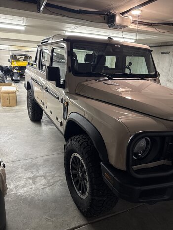

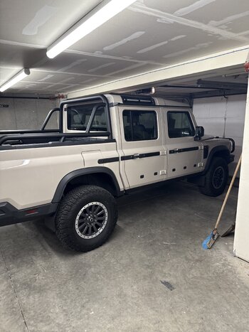

These are the latest pics of the Eibach 2.5 lift with the BFGoodrich mud 35’s. Took it for extensive test drive at speeds over 80 mph. It actually drives and handles better than before.

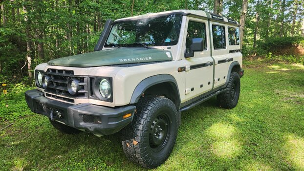

I just lifted mine with the Eibach lift, New 17" Reika bronze wheels, and Toyo AT3's - 285 75 17. No rubbing. I also added a 5th tire to the spare tire carrier. The door still opens fine with only about 1/4" to spare. The backup camera is slightly blocked with the larger tire, but not too bad. These are 33.9" OD x 11.3" wide. View attachment 7852355
What lift do you do? Is it just the leveling kit at 1.2" or is it the 2.5 front 1.2 rear kit?
