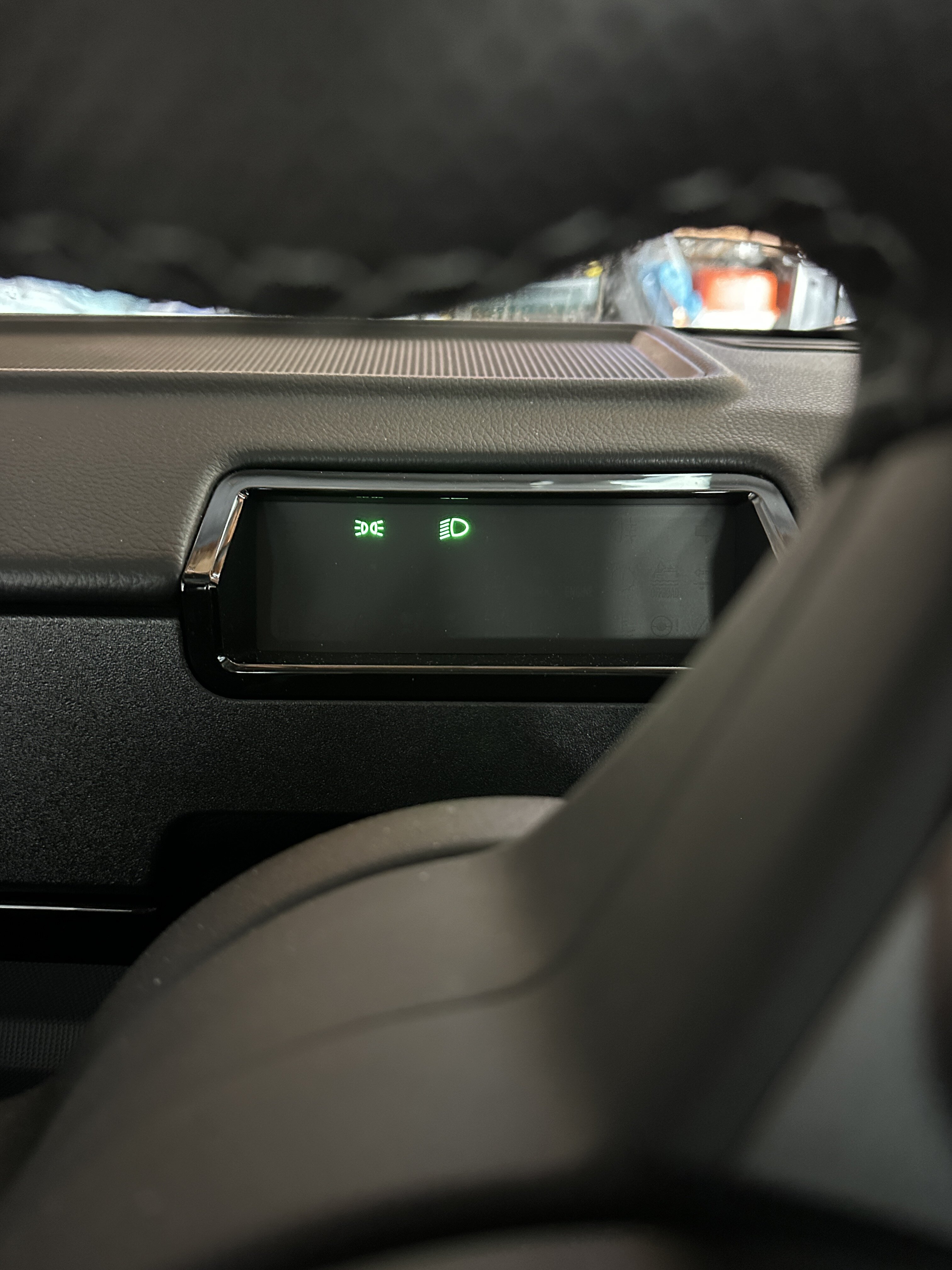

First I had to decide what was bothering me. The clicking sucks yes, but the yellow light on right in the middle of my dash was equally as annoying. That reminder that something “isn’t right.” So this is a simple hack just to try something new. What didn’t bother me is the little speed limit symbol by the speedometer. Who cares about that. It’s actually quite handy when accurate. So instead of turning off the “speed limit info” do this:
Still hit your FAV button if it was programmed by your dealer. When you get to that screen, just turn off the “Over Speed Warning” instead. This gets rid of the clicking, no yellow light on dash, and everything works as it should. Plus my AEB doesn’t go on and off anymore either sporadically.

Note 1: If you Unselect ‘Speed Limit Info’ you will have a persistent Orange Icon on the Telltale Display (That’s the name of the small screen in front of the Steering Wheel).
