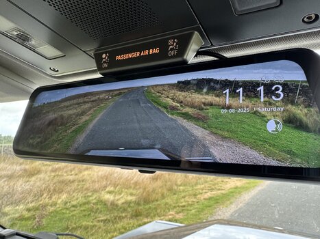

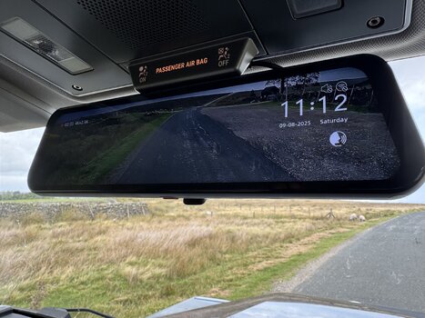

I’ve just installed mine today (pics attached). The rear view is darker (it’s through tinted glass after all) but bright and clear enough for its purpose.
Install issues:
I passed the wire through the ducting at the bottom of the back door. The wiring loom on the door end of the ducting had been sealed in with a generous quantity of latex which ‘cured’ as it was exposed to air. I had to cut around this to allow the rear camera wire to pass whilst protecting the integrity of the grommet.
The OEM mount won’t fit on the metal plate glued to the Grenadier’s windscreen. Wolfbox are sending a replacement metal plate but I have no clue how (or if I want) to remove the original mount.
When the Wolfbox is strapped to the rear view mirror the USB connections impinge on the airbag warning binnacle so they’re slightly under tension. I’m concerned that this will weaken the connections over time.
Overall, a fantastic bit of kit that seems to be well made. I’ve still got the front bumper camera to install but that’s for another day.
Install issues:

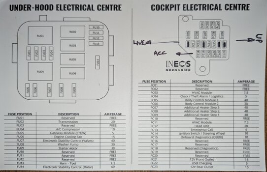

Finished the install but unit will not power on, removed the trim to access fuse box again and cut all my cable ties.
Both fuse adaptors from the kit do not work!!! no continuity from adaptor to connector, thought they we just badly crimped but no.
The actual fuse adaptor heads have no continuity with the fuse holders in the adaptor lead.
Before you install make sure you check the fuse holders for continuity from pins to connector.

I have done a similar installation of a Wollfbow 900Tri Pro and installed the third camera underneath looking forward so I can watch the two front wheels and the clearance over rocks from underneath (very cool) and did the testing taking power from the cigarette lighter. So far so good.
To avoid the power cable hanging about, I ordered the Wolfbox hardware kit with the intention of connecting it up to the power point in the left hand foot well (switched via the ceiling console) as you have. I connected the yellow (constant power) to the live 12v and the black to the other cable of the Ineos prewired pair and blanked off the red (ACC ignition cable) thinking this would mean the Wolfbox would stay permanently on and only be switched off if I switched it off on the ceiling console or got switched off by the "Low Voltage Protection: The hardwire kit monitors the car battery voltage. If the voltage drops below 11.8V, the kit will automatically cut off power to the dashcam after 60 seconds to prevent battery drain".
Unfortunately this didn't work!
The Wolfbox boots itself up only to switch off a few minutes later. Oddly enough, without touching anything else, I have noticed that just playing with the fuse (FI29) can cause the dashcam to boot up only to switch itself off a few minutes later.
Any suggestions as to what is going on?
Did you connect both the red and the yellow to the 12v live of the prewired pair in the LH foot well?
Ideally, the as the Wolfbox instructions say:
"The red wire should be connected to the ACC (Accessory) fuse slot. This slot provides 12V when the ignition is on and drops to OV after the engine is turned off. " Doing so enables the dashcam to automatically enter parking monitoring mode when the vehicle is turned off, which can either be set to continuous timelapse recording or G- sensor trigger recording. Both nice to have features.
BUT who knows what would be the easiest way to get that red cable of the hardware kit from the left hand foot well all the way to an ACC (Accessory) fuse slot?
Where is the ACC accessory fuse slot? I've tried several in the driver's fuse panel but believe they all have trace voltage, thus preventing the Wolfbox from entering the parking mode. I connected similarly to the interior ACC switch so I can power on or off as needed but I would like it to go into the parking mode.
