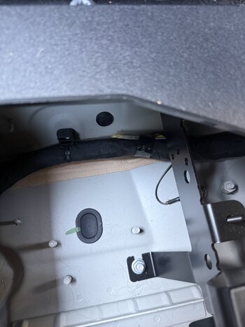

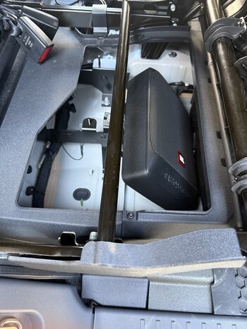

I am planning out an install for a lithium house battery under my backseat and I noticed several white capped wires attached to a wire harness (see pictures). Does anyone know what these are for?
They look like they are the 40a spare supply for air compressor/dust gun controlled by fuse no Fl13
