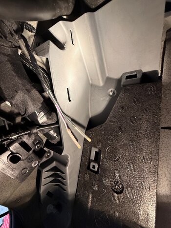

I want to power my GMRS radio from an interior aux swithch but can't find the pick up wiring. On line video only shows the right hand side and I've looked in that section on the left hand floor and it's not there. "AI" says it is in the A-pillar. Can anyone confirm?
Found them. The interior auxillary wiring pig tails are on the LH driver's side too.
I am looking at that image and can't really tell where that is... Could you describe where you dug them out of?

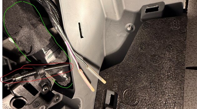

Remove the hood-latch lever, remove the panel behind the hood latch lever, follow the thin black hood latch cable towards the firewall and the pig tails are tucked up under the hoodlatch cable near the larger wiring loom.
In the attached photos, the hood latch cable is outlined in red & the wiring loom is outlined in green.
FYI: The left hand side footwell pig tails are tied to the "INT 1" switch. The right had side footwell pig tails are tied to the "INT 2" switch.

Thank you! Time to wire up the GPS and a couple of other devices!
