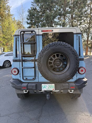

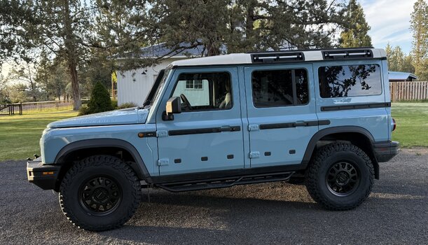

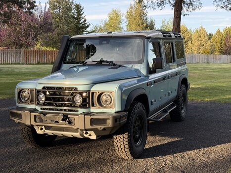

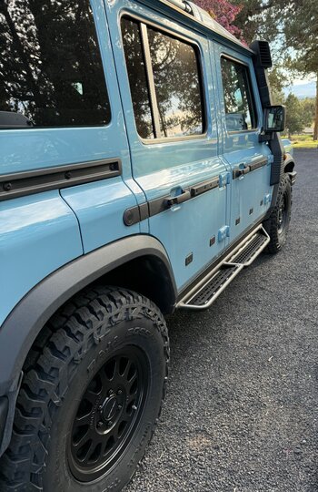

Nothing novel here, but jumped on the Baja Boss bandwagon, 255/85/17 on Method 703s. Stock suspension. The ride is great. No rubbing so far. Need to give it a proper dirt session.
