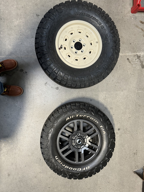

The 315/70/17 Nitto Ridge Grappler's on the Owl Talon Wheels seem to fit with no problem (with the 2.5" Eibach lift). I've tried a lot of situations and have not had any rubbing yet. The wheels have a +30 offset compared to a stock of +55. They stick out beyond the mud flaps and fender guards a little bit, but so does every Jeep and Bronco. I am still playing around to find the best pressure for normal on road driving, but think I have hit the sweet-spot with 35 psi for the front and 38 psi for the rears.
Here are some photos:
Looking at the protrusion from the back right looking forward:
Showing the closest point of contact from the front left tire (front of tire) at full right lock of the steering wheel:
Definitely need side-steps/ sliders now with this combo:
The spare tire is in the back for now, I need to order a relocation kit, I understand Owl will have one soon so will probably just wait for that.
It drives great with these. I was able to recalibrate the low-pressure warning on the tires easily. Just reset it through the menu, just the vehicle completely off for more than 3.5 minutes, then turn it on again and the warning was gone.

These are 315/70/17 or in inches 34.8/12.5/17…Eibach (US spec) 2.5 inch lift. Drives and handles great no rubbing. Spare mounted with offset bracket.
That's the closest point of contact while it is sitting on flat hard ground.
I think you will have a problem as soon as you hit a lumpy offroad trail and turn at the same time that spring is compressed.

That’s the whole point of my update - having done about 8 combined hours of trails since install, today’s the most challenging, I’ve yet to have a single rub. There were many times I had to turn lock-to-lock while fully flexed or fully compressed on each tire. With that combination (315/70/17, 2.5” Eibach lift, +30mm Owl Talon wheels) I have yet to encounter any rubbing. This was with 3 adults, 2 dogs, and the back 50% full, fuel tank full.

What I was saying is that the offset I am using is a +30 vs the +55 factory Jsharifi was talking about. Also I am using a 17 inch wheel with 315/70/17. That equals a total diameter of 872.8mm (34.36inch). If you had the same tire on an 18 wheel (ie a 315/70/18) that would be an 898.2mm (35.36 inch) overall diameter. I am saying that size would probably not fit.
