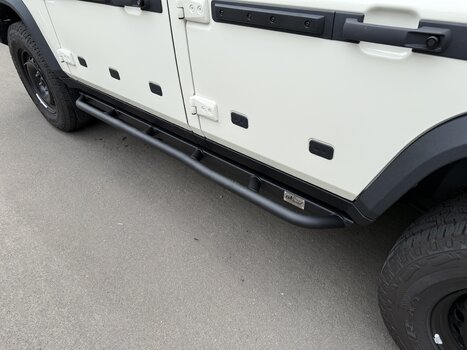

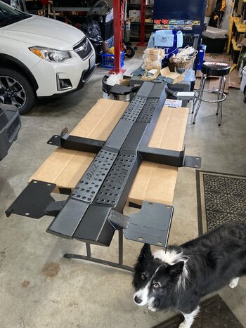

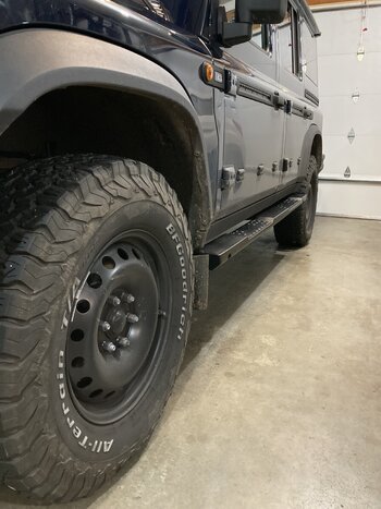

I have a set of the Buzz Overland sliders. I’d give them 4 out of 5 stars. That last star I hold back for 2 reasons:
1) The driver side required clearancing of two holes on the front mount to achieve proper installation.
2) The stainless steel washers provided were way too thin. Some of the holes are oversized to allow for ease of installation and properly aligning. That means the washer is only contacting the mounting plate on the outer edge of the washer. I ended up buying larger/thicker washers and scrapping the ones they sent.
Overall I think they are the best looking and most functional due to the integrated step. It’s a 95% on-road commuting daily driver so the step functionality is hugely important for me.

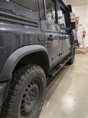

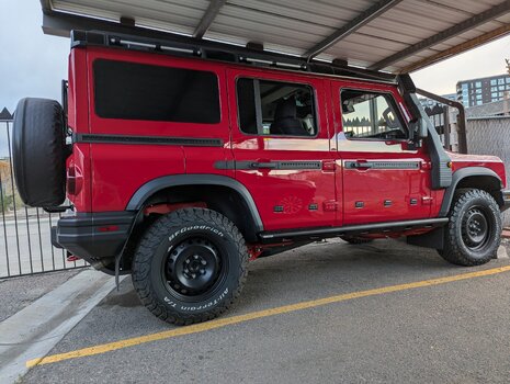

I built some steps to start with as I could not find any sliders that I liked or were easily accessible until I found these:
They look vaguely like the Abenteuer 4x4 sliders, but a bit lower and with a center frame mount.

How do you like these in terms of daily function? Does it assist you in stepping at all, or do you just by pass it all the time? I looked into those, and wanted to confirm if they're frame mounted? I love how they look very similar to the Agile Offroad ones, but the AO ones are body mounted and I just don't want to deal with that.

Can you elaborate on number 1? I am slightly confused on this. Are you saying there weren't holes present, or they were mis aligned? How was it fixed? Keeping things loose and then tightening little by little?
Have you taken them off road or beat them up? If so, any issues?

I like them. I beat the piss out of them on a trail yesterday and they are holding up great. I don't use a step to get into the truck, but I use them all the time accessing the roof rack. It's not a large step, just enough to work. I usually open the doors to have a bigger step since you can only really get your toes on there when the doors are closed. Here's my post from when I mounted them.

I have not had to use them yet, but they are very stout, and being stainless steel, if/when they catch a rock, it won’t rust.
The issue was the holes in the mounting plate didn’t quite line up with the threaded holes in the frame. It was about 1/2” off. So it was a combination of clearancing the hole a little bit and prying with a big crow bar after loosening up all the other bolts.
