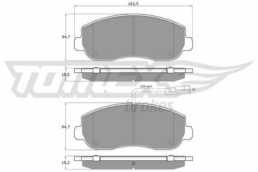

I am not sure but some digging yielded FMSI numbers for Grenadier's pads.
Front pads - 9168-D1944 (it can also be labelled D1944-9168). Looks like the fronts were used in Acura NSX (2016-2022), Mercedes MacLaren, and Maserati Grand Turismo. Brembo lists the first as P50078. Autozone lists the part but tells you it won't fit a 2024 INEOS Grenadier.
Rear pads - 9123-D1895 (also D1895-9123). A Google search for those brings up 2017-2020 Audi A6, Q7, Q8, and e-tron Quattro A8.
FindItParts.com has both front and rear pad kits in stock.
Now... the part numbers for the pads were found on RockAuto website. I don't know if they fit - ordered a set, will report the fitment results.
OK, these are DEFINITELY WRONG part numbers.
Cross-listing from INEOS parts manual:
Front:
GRA-6A70-021170 (INEOS p#), FMSI D1984 9212, Brembo p# P68062 (EAN 8020584110072), Delphi p# LP2190, EBC p# DPX2083, Ferodo p# FVR4347.
A lot of cross-listed part numbers here: https://www.trodo.com/brake-pad-set-disc-brake-brembo-p-68-062?currency=USD
Rear:
GRA-6A80-020670 (INEOS p#), Brembo p# P68063 (EAN 8020584110089), EBC p# DPX2084, Delphi p# LP2191
Lot of cross-listed parts here: https://www.trodo.com/brake-pad-set-disc-brake-mapco-6945
Please set me right if I am wrong again.
