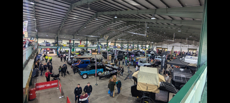

Drove up to the 4x4Expo today. There were a lot of posers and land cruiser and only one Grenadier ( chap selling tyres? ).
I did drive around the car park at midday and only spotted one other Grenadier in the parking.
Pic shows about a third of the event floorspace

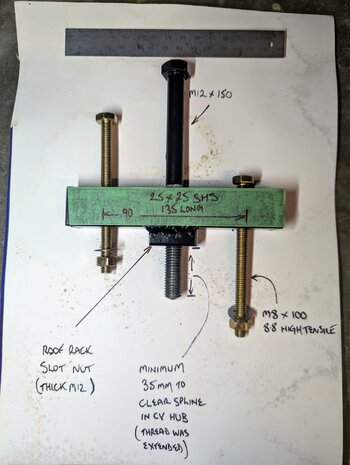

Continuing my post above, one CV hotfix kit ready to go. Just add hand tools, rags and sweary words.
  • pre-greased CV
  • cap gasket cemented in place
  • two sets of class 12.9 cap screws (16)
  • bolt tabs
  • new boot clamp plus spares
  • new shaft circlip plus spares
  • tube of Loctite 243
  • extra CV grease

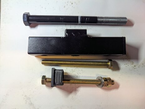

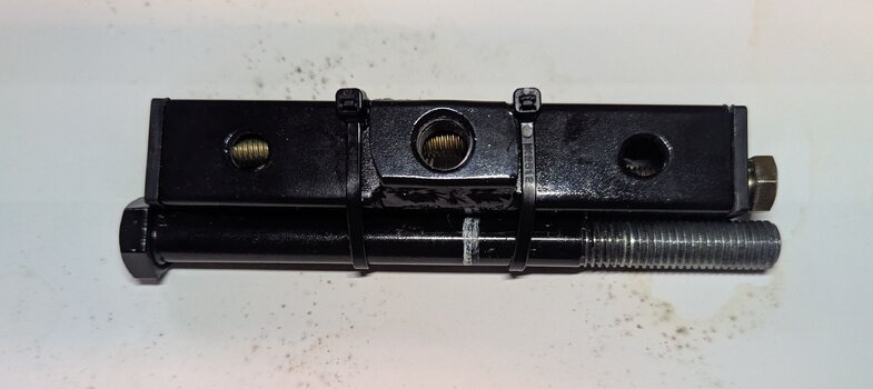

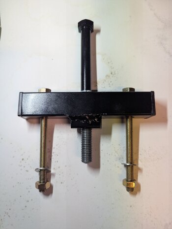

  • Purpose built two-bolt puller to remove the old CV (if needed)
I've gone with class 12.9 industrial socket head cap screws because the factory torx screws have been known to break during removal which I think might be related to the red thread locker used at the factory. If they have used Loctite 263 or an equivalent it needs heat to release it.
I'll use medium grade Loctite 243 which is still suitable for M8 at ~45Nm finished torque but it only needs hand tools to undo it.
Again, this is just insurance for a worse-case self-recovery scenario. I'm running standard height suspension so a driveshaft or CV failure should be warrantable.
I'm happy to loan this kit to Australian forum members on a replace-what-you-use basis. Provisos are that I don't need it at the same time and you collect and return it promptly or pay postage both ways.
DM me with dates if you're interested. It will be available from 3rd April (Good Friday).
Edit:
Puller pics added. This was the materials what I had laying around in my workshop. The only critical dimension is the 90mm spacing of the legs to align with the CV hub bolt holes. You also need to ensure your centre bolt will extend through at least 35mm to push the spline out of the CV hub.
Ask questions if I missed something you need.
