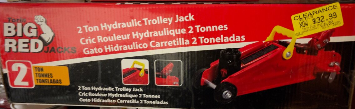

Made a trip to one of my local Tractor Supply stores. Typically this is nothing of note except I bought this for my Grenadier…
As you will see it was on clearance from $54.99originally…the reason for posting this is to those in the US aware that TSCis offering 50% off clearance so I grabbed this for a measly $16.50!
I bought it in the Derry NH location and they had 3 more left after I purchased mine.

Nice. Old school lift kit and the only safe way to lift your Grenadier 😎

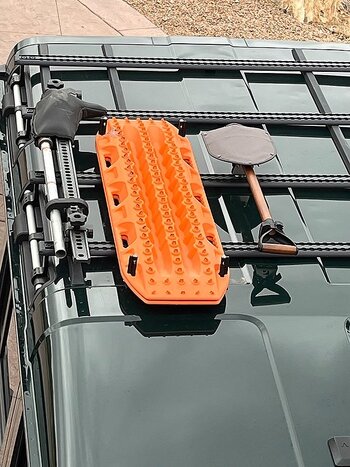

I finally sorted out the daily configuration for my roof. The rails and recovery board carrier are from DVA. I like the low profile and they are sufficient for anything I plan to carry. The Hi-Lift holder is the Rhino Rack 43219. These are set up for M6 T-track sliders, so I bought the M6 sliders from DVA. I had to cut down the bolts that came with the Rhino just a bit. The shovel holder uses riser mounts and clamps from BuiltRight. These provide enough standoff from the low profile DVA rails that I don’t have to worry about the shovel head making contact with the roof. I used M8x20 L track bolts from DVA to mount these. I still have enough space for my unwieldly 52" long Gazelle internal frame tent which I'll strap down with RollerCam straps.

Which shovel is that, Steve?
