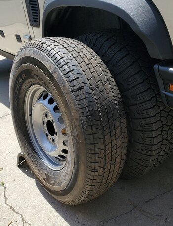

Test-fit a 16" steel wheel on my Grenadier - clears the front brake calipers with a 1/4" spacer, while still remaining hub-centric. Plenty of threads on the lug studs.
Short - term: a 255/85R16 second spare.
Long - term: a set of 8.25R16 XZLs. Maybe.
Tire mounted.
Now I have a full-size spare on a 16" rim.
