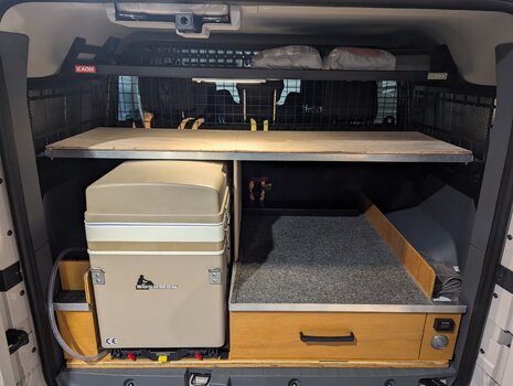

I installed a removable rubber mat on top of my diabolical drawers.
Works great, cut to shape and doesn't move around.
Only problem is that it stinks... I should have aired it out for a couple of days before installing it, smells like tar.
Easily cut to shape with a trim knife or a razor blade

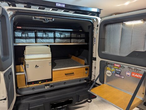

Completed my middle shelf, fully installed now. Getting the full length required assembly in the car. The plywood also needed to be in 2 pieces. It is mounted to my kaon side panels and has a plywood middle support.
Shelf space is 440mm deep, 1430mm wide, and a height between shelves of 235mm. Perfect to allow front runner cub boxes or front runner soft bags.
This system has added roughly 125kg
Homemade draw unit - 26.5kg
Slideitsolutions Fridge slide - 8kg
Bushman 35-52 fridge - 24.5kg
Kaon upper shelf and side molle panels - 20kg
35litre water tank behind drawers - 40kg full
New shelf and support 6kg
Next up some interior lighting.
