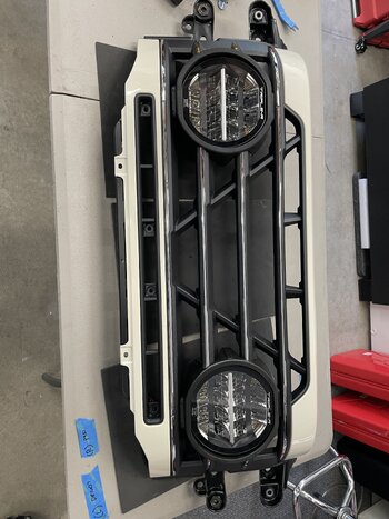

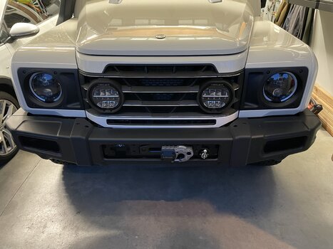

Finally got the Triple R (aka LAZER lights) Sentinels Installed. Pretty straight forward install. Only nerve racking part was cutting the grill, but they supply cutting guides which made it pretty easy. I converted to deustch connectors and wired to switchpros instead of overhead console.

Awesome! I did the amber as well. I considered using the aux switch, but opted using the switchpros for ease of use and options it provided. I also wired the drl’s so I can turn it off and on whenever I wanted
Awesome! I did the amber as well. I considered using the aux switch, but opted using the switchpros for easy of use and options it provided. I also wired the drl’s so I can turn it off and on whenever I wanted
that looks very neat indeed 👍

I did it with a multi tool with a wide wood bit in it. It made a really nice job.
You sir are an engineer, I'm wobbly at best with my Makita. Think I'll use my hacksaw to start. I may have to dm you some more mid build/demolition!

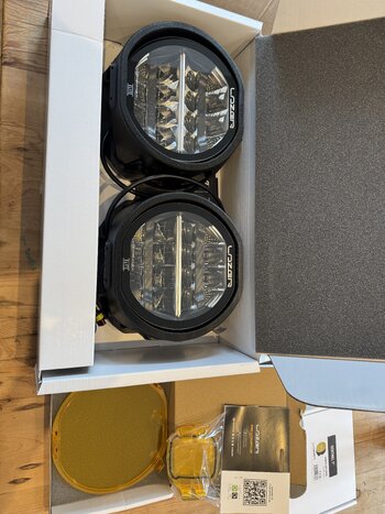

Also took your advice;
Were you able to fit the yellow lens covers? I was considering getting them but wasnt sure if it would clear the housing?
Good question. I bought them but on reflection I don't think they will fit in the housing. I might send them back. Will let you know once have a definite answer.
