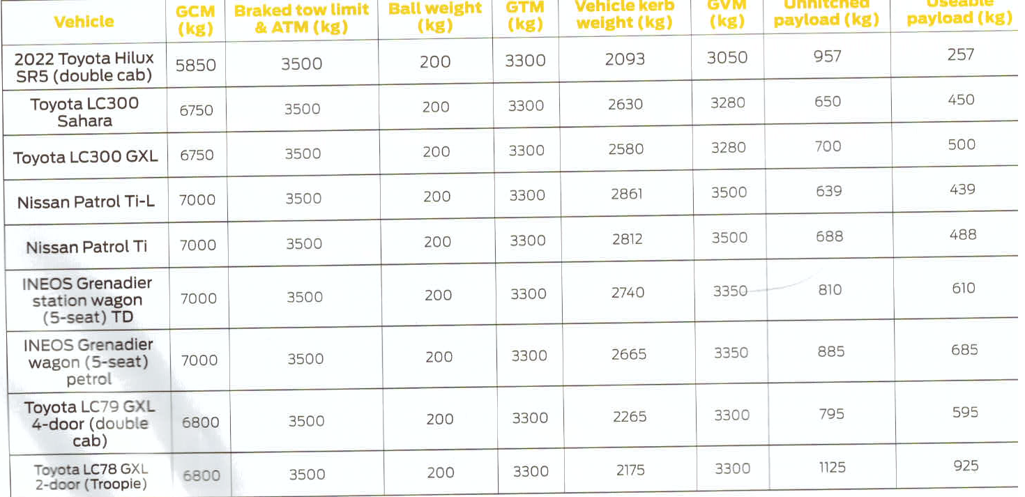

My interest in the Grenny was sparked by an article in issue 629 (Nov 2022) of Caravan World (oh how I wish I didn't live under a rock sometimes and got on board a lot sooner :cry:. The three page article titled "Could there be a new king in the tow stakes?" focuses on comparing the Grenny's specs against other popular caravan tow vehicles. Much of the article focuses on the why and how each of the various limits so just to make sure we compare apples with apples across different standard/countries this is an extract.
The comparison is summarised in the following table. The 200kg is not actual Ball Weight limit, it is just the weight used for comparison

Thought Grenadier GVM in Aus was 3550? typo maybe?

Thanks for posting this Paul.
Towing was what first sparked my interest in the Gren, when they were aiming for 1000kg payload.
They still sell the Grenadier short effectively another 70kg approx of payload in these type of comparisons.
The Grenadiers weights are listed with 90% full of fuel, I can guarantee you that the other cars on this list would only have about 5% (nominal amount) of fuel in them when weighed, thus skewing the comparisons.
The Grenadier is the king of payload still, the lc300 is a joke in comparison. All caravan magazines should be taking more note, as all of the towing specifications of the Grenadier are superior, wheelbase, track, less rear overhang etc etc.

It also includes the tow bar, bash plates, ladder, steel bumpers, etc etc
Is there confirmation of that? I've kind of thought that it might include some of these items, it makes a massive difference. The grenadier builder does not specify end result payload. It's vague in my opinion but I might have just missed it somewhere.
The other manufacturers listed above are stock, i.e. very little or no protection, standard plastic bumpers. Putting decent equipment on takes away a fair bit of payload.
This would mean that not only is the listed payload higher than other wagons but the payload already includes a lot of rather heavy items.
Yes there is as they list the payload for each version which includes it's standard options however it looks like it doesn't include the ladder
Payload is 90% fuel, all fluids (adblue) but no driver.
This is from the Australian spec with steel bumpers.

So have a look on the data for the Belstaff Editions. Don´t mind the German language as its the same as in the table of DaveB. With all the luxury stuff the payload melts down like snow in the sun.
That's the table I was looking for.
Compared to most other vehicles out there that is still a very good figure
The European Belstaff edition seems to weight at least 27 kg more than the Australian "naked" SW. That might be the extra weight of ladder an luxury
