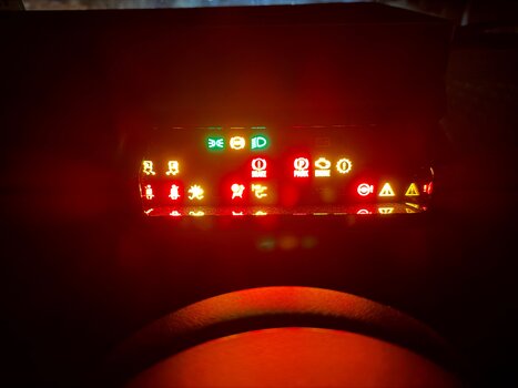

I was traveling for over two weeks and tried to start my car last night and it fired right up but I got a ton of lights (picture) and I was going through menus my battery charge level was zero. Turned the car off waited 20 minutes and even before the start the gearbox warning was on but after I started it the battery charge level jumped to 83. Let it sit over night and just tried and all the lights are on but the charge level was 78.
After reading some posts do I just disconnect the battery and let sit for 15 minutes?

Ours will occasionally return a 0%, I don’t know if it’s my imagination but I suspect it occurs when I don’t give it a pause at ‘on’ before turning the engine over.
Similarly we seem to occasionally get a TSA fault if the vehicle has been sitting for a bit or if I have the fridge turned up on startup (voltage drop?).
I believe the cool down is 6 minutes after key off and both of these exceptions resolve on next startup without disconnecting the battery.
If you are going to disconnect the battery, wait that 6-8 minutes per Owners Manual instructions, as to not do so is to risk the ‘Airbag Fault’ warning which takes a dealer visit to clear.

I have tried a bunch of combos from waiting over night to make sure the key is out of range and in a cage plus everything is turn off on start.
Most of the time the gear light comes on and stays on till the dash turns off.
Attempting to disconnect the battery and took the three screws off but not sure if I am just being to gentle on the box protecting the battery.
Searched the online tech manual - probably not looking in the right area.
Any suggestions? A link?

My next step in that case would be to connect a battery charger/conditioner. I have a NOCO Genius 10 which does a really good job.
I’ve noted different results when I connect it direct to the primary, direct to the secondary, through the jump start pole and through the Smartpass (I’ve now hard-wired it there).
Through the jump start pole and direct through the Smartpass it will top both batteries (eg the charge distribution appears to function with power off).
HOWEVER I believe in this format it’s not conditioning the battery correctly.
Attach it direct and it will run the battery in question up to 100%.
That’s all a bit unscientific Christian, I hope it helps. We are on the road 18 months now and I don’t have independent charge monitors so we’re flying a bit blind.

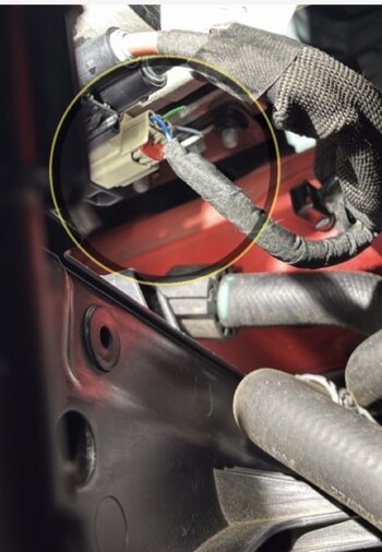

So had to tow the car to the dealership. Not the cause that I expected as an animal decided to eat the wires which is perplexing because I have LR parked right next to it and never had an issue for the four years where I have lived; I guess the Grenadier is more appealing.
Can't wait for the bill to fix this...
Obviously, the rodents have exquisite taste.
Thanks, waiting for them to get back to me as they fixed the power steering which seemed pretty simple but the wheel sensor was a little more consumed as it ate all the way back to the bundled.
