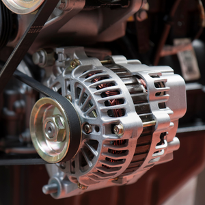

Does the IG have a smart alternator? (Sheepishly adds I have no clue what that even is)
Upvote 0
It appears to; if you look at the "Electrical" screen on the Offroad set on the screen, it shows the battery state and the rate of charging. With the battery at 70% or more, the level of charging is minimal, at 50%, the level of charging is huge, with higher peaks as you come off the throttle.
A smart alternator is one controlled by the engine or body ECU to reduce drag on the engine, keep the battery with pre-set limits by altering the level of charging from the alternator to the battery dynamically. On breaking or coming off the throttle, the alternator will increase the amps produced to harness the otherwise wasted energy.
Upvote 0
I think virtually all modern cars have smart alternators as helps cut down on emissions apparently
