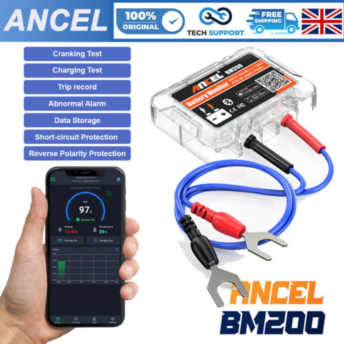

I posted these before but haven't found the post ... get two of these, one for each battery, they cost very little and you are able to see the SoC of your batteries on your mobile phone at any time + get a whole lot more about thier status including if they are being charged....
I bought one for the Aston as we don't use it that much in the winter, range is around 20M
