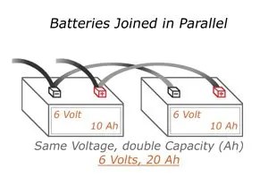

The Black (neg) are connected together already (common earth)
Connect, start the car, remove the lead.
It would be highly unlikely that both batteries were 'dead' - it's possible, but I would estimate that 99% of the time this would get your car going again.
It's better, and safer, to disconnect the starter battery first.
The ”dead” battery will start sucking power from the service battery as soon as you connect them.
The current may be so high that you will not be able to start anyway, or the connecting cable may catch fire.
In general it's never a good idea to connect batteries that are not charged equally.
My 2 cents.
My 2 cents.
Have a nice day, Fabio
@Fab that was the aim, to connect the two batteries together that are not charged equally, so that the car that was in an innoperable/emergency situation, could be started.
When you ' jump start' a car or attach a NOCO starter pack (other makes are available) that's exactly what you are doing , connecting two batteries that are not charged equally.
I said...
You should use a Heavy Duty cable with clips at each end.
Connect.
Start the car.
Disconnect
If you had disconnected the starter battery - how would this help you ?
The current would be relatively high, probably, and if you used a thin wire (like that used to connect a radio or a light bulb) the wire would have got hot and probably let some smoke out (Replacement Wiring Harness smoke is available).
