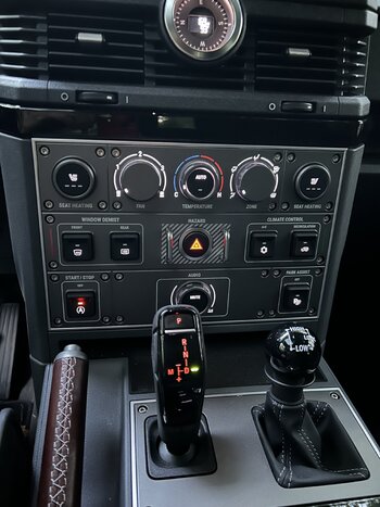

Hi there. Just done my UK RHD shifter swap today. Took 2 months to come from Toyota £275.00. Overall took 20 minutes including stripping the new one. The ribbon going through in the new one was a bit fiddly but a bent paperclip hook & patience soon sorted. Easy DIY job at home. Delicate on the ribbon. Thanks to Owl on YouTube. No looks like it should from the factory......Ineos..........

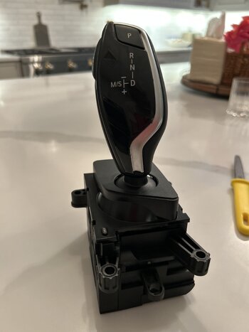

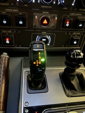

Done with mine. Love it. As I suspected, the volume knob is easier to access. And btw it does glow amber at night. Got the old one back together with no damage. I used a panel tool after using my nails to create a small gap enough to fit in. Only additional advice I have is to remove the circuit board for the new shifter and fish the tape connector through before you seat the new shifter on the Gren's base. I used a toothpick to help it along. Thanks to everyone who contributed to this thread.

When you get the ribbon out of the connector remove the circut board on both the handles, there is nothing holding it in at that point and it makes reassembly simple because you are not threading in from behind the board.

2) Suggest testing your ribbon connection BEFORE re-screwing/snapping everything back together. It saved me from having to disassemble everything because I didn’t fully insert the ribbon. When I turned on the ignition the first time, I had a gear box error warning and it would not shift to any gear. The shifter lights also did not come on. Once I got the ribbon positioned correctly, it lit up like a christmas tree and everything worked as it should.
