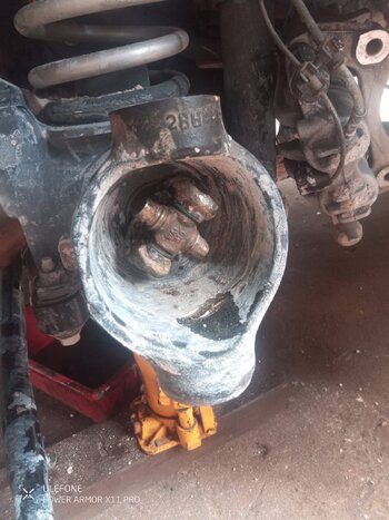

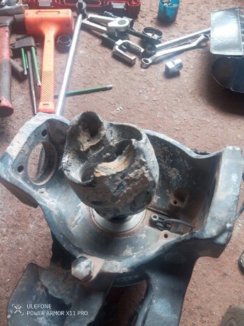

Double cardan joint in the front axle failed. If anyone is able to help I think he’d appreciate it. He’s got two kids with him.
Needs parts sent to Bamaga in Australia. This could also be a good time to deploy the flying spanners service surely? Or perhaps Justin can help. We’re a bit remote ourselves at the moment and so I thought I’d put this in here and let the community do what we can to help collectively. 💪

Looking at the photos it looks like the lube washed out or was contaminated and the UJ siezed , everything is dry it doesn't look like a sudden diff lock induced failure.

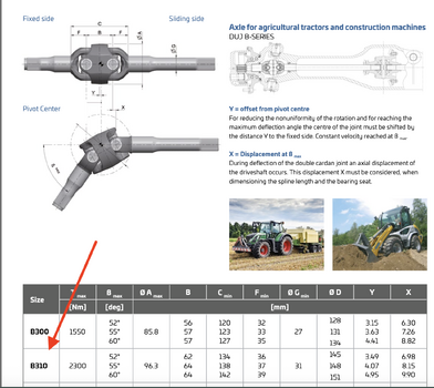

I'd check for part numbers and also measure the UJ itself. The cap diameter, the overall width cap to cap and because this is a DC joint the distance between the two joints. Universal joints are commonly used in all sorts of equipment, I once fitted the UJ from a tractor PTO shaft onto the drive shaft of a LR discovery. It worked fine for years.
I'd check with any agricultural or mining suppliers in the area and give them the measurements you might just get lucky...

I am not an expert on U-Joints, but with the number WAL 310 on it, it might be a Walterscheid brand, which would not be uncommon for a Carraro Axle.
That's a private page, so, I don't know if I'm seeing all pics... Is there no centering yoke on the DC, or are there parts lost in the explosion?
Well done! I bet thats it. I think they are also found on the IVECO 4x4 Daily. So thats another avenue to try...
