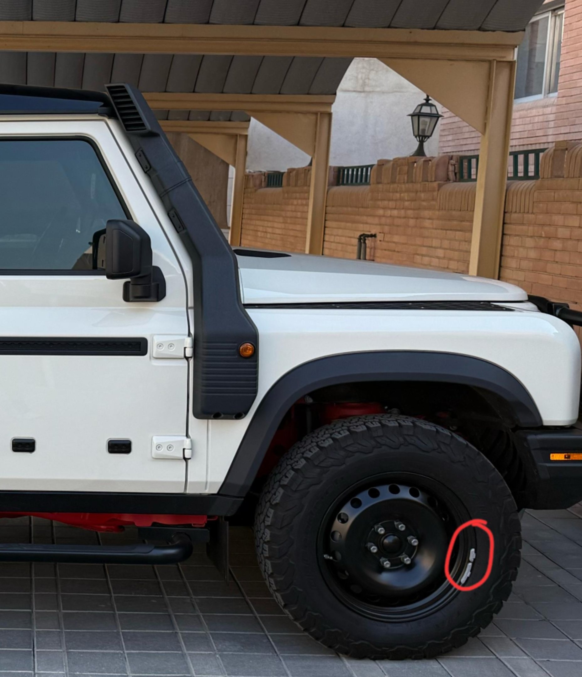

Faced the same issue initially.
Heres, my fix
1- go to a decent tyre shop and let them remove all the tyres and recheck them to add the necessary wieghts alignment- check the picture
2- install a steering damper from fox or owl or Bilstein it will cost around £500 - check mine attached
