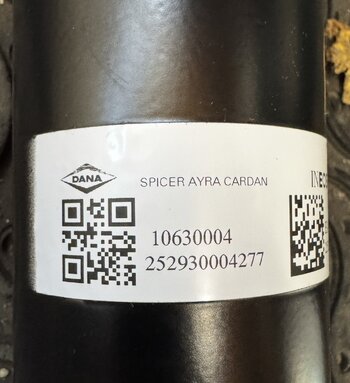

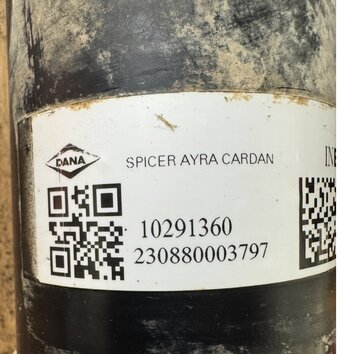

Probably worth mentioning on future shaft failures what the part number of said shaft is. So far as I am aware there are two;
Original one in first photo, replacement in the second. Will be more data to see whether the average failure mileage improves with the new part number one.
